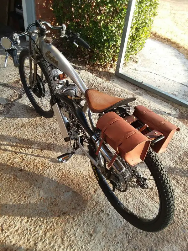

Thanks guys. The bags utility swap between the hybrid & this is really important on the my mountain bike extending the range tremendously. I can see pedal assisted 120 miles per day cruises on the MB quite possible since I've been getting fifty miles on a single charge, with pedal assist, on the road with one of these 16 amp batteries. I typically save the batteries for ascents or when riding into the wind. 48 amps is a game changer for route planning on longer mountain bike rides.

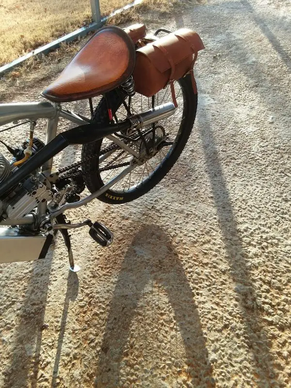

I re-enforced the bottom of each bag with a 1/8" thick layer of rubber & straps are heavy weight doubled leather belting with double leather washers on each side of every brass Chicago screw connection. I also re-enforced the bag inside with the same size strapping used on the outside, so each screw used on the bag has 1/2" of leather re-enforcement. I used some of the 1/8" rubber between the fasteners on the straps in place of leather, still 1/2" thick. It's pretty robust. Two batteries equal 14 pounds, bouncing across secondary roads, I wanted strength. The bags themselves aren't made of supple leather, but rather hard so I think they will wear & hold shape really well.
