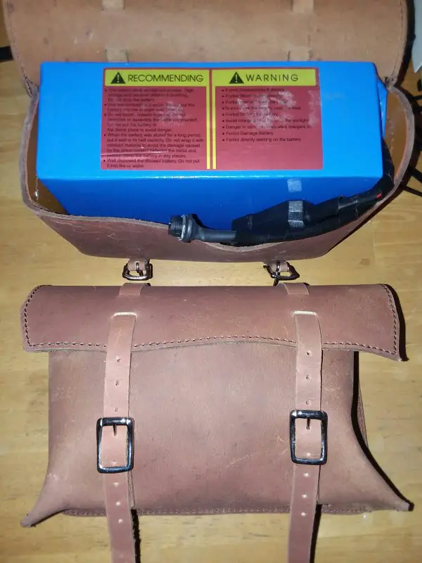

36 V. lithium packs fits these leather saddle bags perfectly. I could have used these on my Fall ride to free up space for extra gear in my nylon rack bag & back pack, but they will be very useful on future bike adventures. I can quickly dismount these for local rides or swap them between my e-mountain bike and the Hybrid. Just better utilization of batteries I've already purchased as well as great range extenders. Pedal assisted on my mountain bike I'd think 170 mile per day quite possible now using three batteries and with motel charging overnight some extended cross country riding on the MB is in my future.
With 4 batteries on the Hybrid I could ride a lot of the state highways at biking speeds, in required sections, while pedal assisted using the electric and not having to worry about the State Troopers. ICE just used for the secondary roads. That's my current thinking till a cop tells me I'm in violation.
Rick C.

That's KOOOOOOOL! Rick. Bags also. Would you bring them inside to charge, or use outside plug-in? Like your thinking for long range travel, Like your mock-up of the V twin, looking mighty fine, right proportions...........Curt

Thanks Curt. I'll set these batteries up to switch between different bikes and the batteries all have the same connecters installed for both charging and running. Battery's just lift out of the bags so charging is either in the bag, on the bike or take out to charge, easy as loosing the straps & buckle.
I still have to connect the two bags for easy rack mounting on two quite different rack arrangements...I'll give this some thought.
