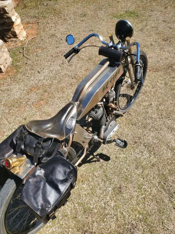

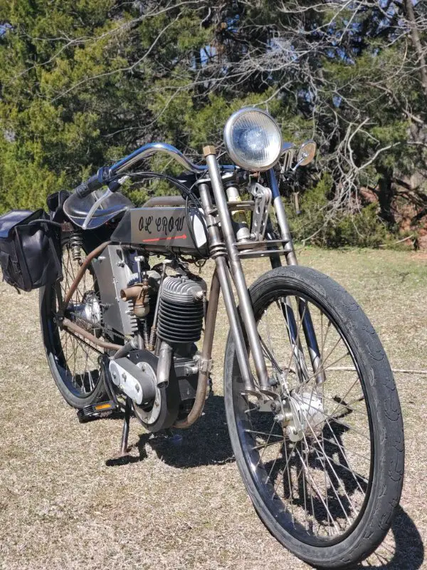

Photo of a much changed Ol' Crow with top of line Sportsman Flyer fork, 12 volt led lighting (1954 era light can) and 1930's style Flander's bars. Scissor style shock also from Pat's shop. No longer a board bike but an upgraded cruiser style. Tank ard both saddlebags hold 20 amp hr batteries wired in parallel for 60 amp hr total...gives great range with auto switching between the three so seamless operation on the go.
I've a few thousand miles on this bike and ride it more than all the rest combined. 3"x26" (27" diameter actual) Vee tires, pedi cab tires, from Thailand are in my opinion bullet proof tough as heck 60 psi tires. I do however wish they were availible in a vintage street tread pattern

Hi Tom I've planned on a full SF frame, including this heavy duty fork for quite some time as I like the look and as the Ol'Crow grew in weight I was really pushing the limits of that four spring fork with weight. I think Pat's fork is about 15 lbs heavier and way more robust. Also this fork allows wider and taller tires with more clearance. I run 26" wheels 3" wide tires and the height inflated is 27" and there wasn't much clearance height wise. Pat's fork has enough room to mount a front fender with a big tire if I want to at some point. The final point was it was designed to run motorcycle handle bars (two point attachment) versus bicycle style bar mount.
In use Pat's Harley style fork works better with my bikes weight as does the scissor shock rebound. Of course my previous fork had zero shock and felt like a dual spring Monarch fork in actual riding. Quality is first class as I expect from all Pat's products. I figure it's an upgrade to an actual 19 teens Harley fork and shock, that said it rides like one might expect with 1912 replica parts. Better than some late fifties and early 1960's hardtail cycles rode! I used Flanders road bars, but have Pat's board track bars too if I ever want to change back to a racer look.
I can't give an actual report on tuning the scissor shock as I put it on and tightened it a little and it's working fine. I suppose I should experiment a little to refine the rebound, but haven't had the urge. I'd say I'm getting close to 500 miles on it since install.

I always get a kick out of seeing your bike, Rick. I will say from my own experience the Harley style forks clunk around as good as any other 100 plus year old set of forks. A very primitive design for sure. In practice I find I can run the friction shock pretty tight. I tighten the bolt till the fork action starts to lock up, then back off just a bit. Too tight and the action can lock up on compression and not return. Still, tighter is better.
Thanks Pat for the compliment. You supplied good "Bones" to build upon...none better. The special "deep dish" frame is the key to making this build possible. The head badge reads "Sportsman Flyer" 'cause it is...with a few drive train and cosmetic changes only.
Patina on saddle is lots of time spent riding. It will take awhile for the saddle bags and tool bags to catch up however. As I ride this bike most of the time it shows character.
Good input on setting up the friction shock. I will increase the pressure at the friction points. I like the realistic ride quality of both frame and forks. The best way to experience the Golden age of bike innovation without speding a $100,000 plus on an original that would be a full time maintenence job to ride on only a few special occasions. This is my everyday ride and dependable fun. Pull a trailer load of groceries or attach a side hack (not yet ready) but I've had the frame attached and it seems to aggrevate law enforcement here a lot.... lol.
