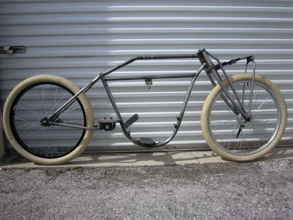

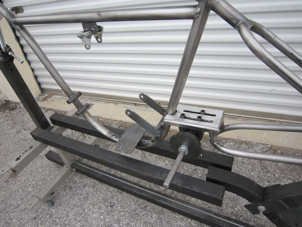

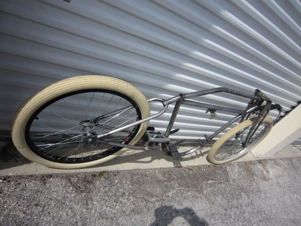

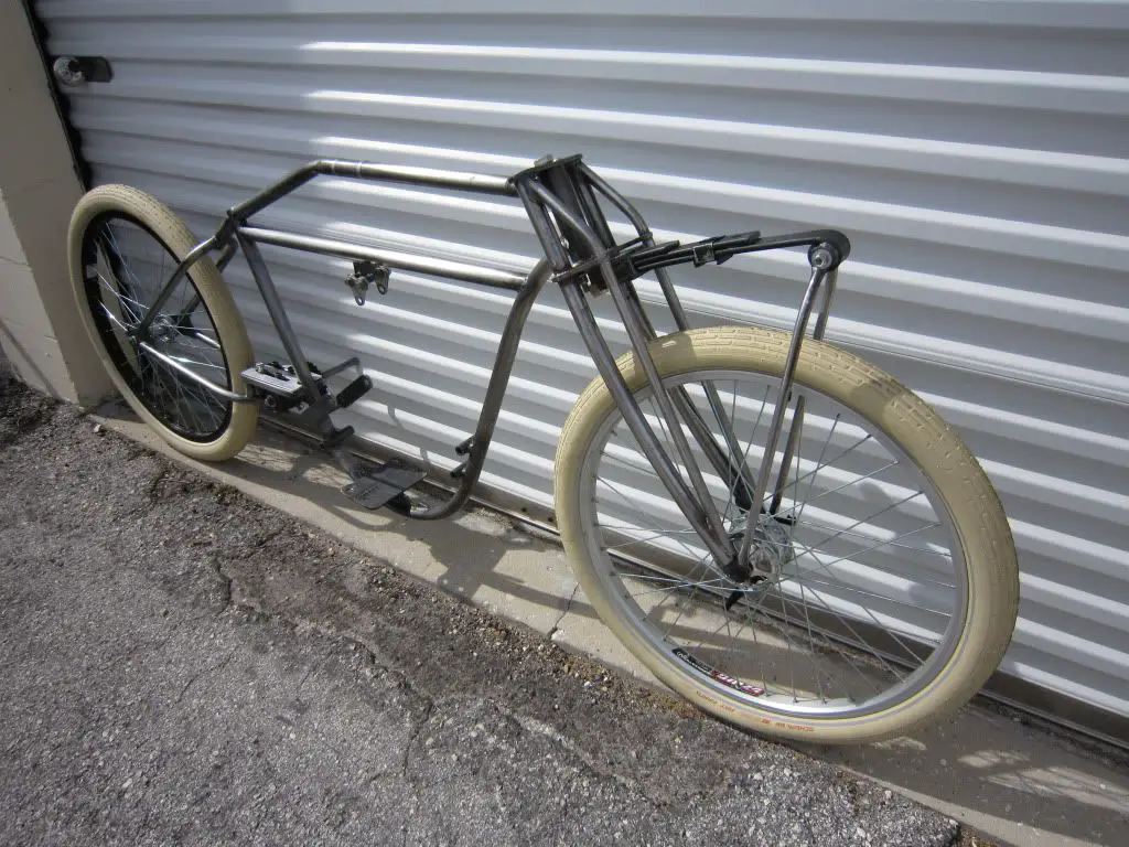

Well, I finished the bottom motor mount today and popped the frame off of the jig. I put the wheels and the forks on to see how it sits. When I install the pivots on the front forks the front end will lower just enough for the frame to sit level. So far, so good!

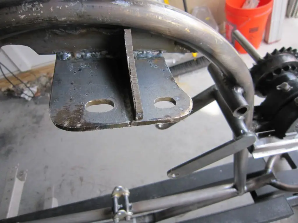

I forgot to mention this photo: This is what happens when you start losing argon while tig welding. I had a meter valve failure and lost half my argon before I found the problem. I will need to grind and re-weld this joint, but I have to weld the gussets anyway so it's only a little extra work.
Next up; the gas tank!
[/IMG]
gnu, the argon is a shield and acts as a flux in both tig and mig welding, once the argon runs out, ****tyness ensues as you can see from my weld.
One thing I have noticed is argon flow-rate seems more critical in mig welding then with tig. Not sure why that is...
i understand the gas is a sheild gas , what I meant was if my pressure fluctuates or the sheild gas is blown away by wind or what ever you will get a porous an crappy looking weld . I have also tried using lower pressures an different gasses but for me co2 an argon mixed works best .
I have a question for you. If you are using a Lifan engine with a five speed transmission and you are going to use a reduction jackshaft, how are you going to run it? Have the jackshaft 1:1 so it really isn't a reduction? Never go into first or second gear and just run it as a three speed? Put a very small rear sprocket on it to compensate?
I am using a smaller final sprocket.
I could not calculate the exact gear ratios, only get close, so I have some options to slow it down if need be with the jackshaft setup.
I am using 1:1 from engine to jackshaft, a 26 tooth gear next to that and a 36 tooth sprocket at my rear wheel.
