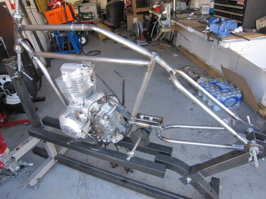

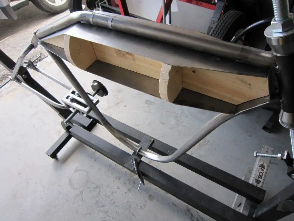

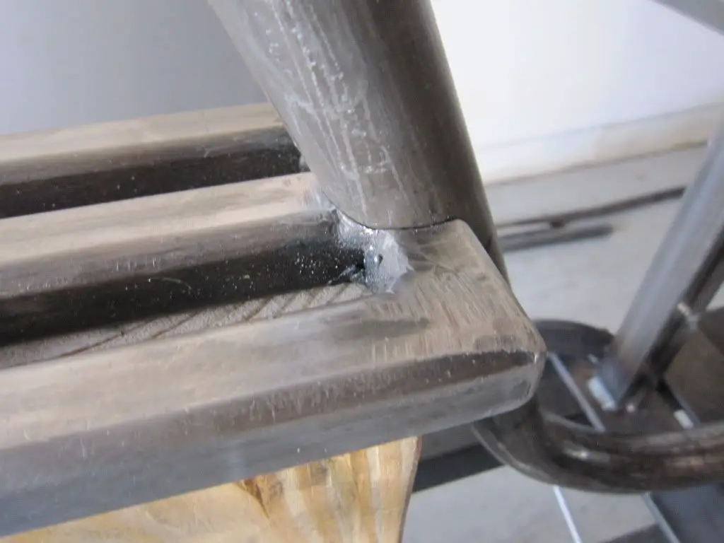

I finished the rear triangle and started mounting the motor as you can see from the photos. I also started building the tank. I am using a wooden tank jig so I don't have to continually refer to the frame while fabricating the tank. You can see hoe close the tolerances are for my tube cuts; close cut, tight weld.

That's really coming along. Your tank jig is interesting and I very much like the shape of it. Please take a couple more photos as you go along in fabricating the tank. How will you bend the side pieces? What gauge steel is the tank made from? Should make a beautiful tank!

silverbear, I am using 18 gage steel for the tins. I don't have a slip roller so I am using a 5" PVC pipe, cut in half to shape the curved sides of the tank. I will sandwich each panel between the pipe halves and then apply even pressure until I get the arc I'm looking for from each piece.

Clever! Oh, I like that. Can't wait to see how it turns out...

I was thinking of your build on that tank this moring an had to post up this I used 4 inch exhaust tubing to build my tank its heavier wall an easier to weld on . you may have a hard time getting 18 gauge to bend smoothly an retain its curve the way you described because all steel will want to spring back once you take it out of tension or pressure . just a thought if you havent started making that tank yet . or alternatively a sheet metal shop may roll out your metal , for a few dollars I found one local to me by looking for metal fabrication shops on google . hope this helps .
