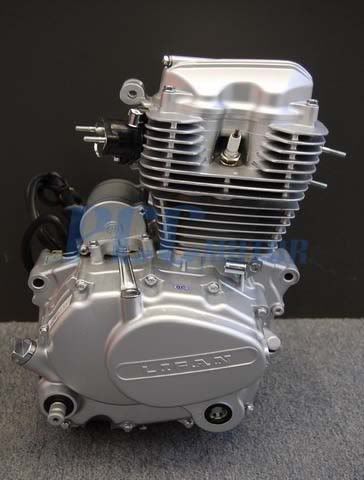

Yes the forks were designed to go both ways so if I race it I can pull the pivots off, but this will be a daily driver like Cobrafreak's. I am fabbing pivots with brass bushings for heavy use. I have a lifan 200cc motor with a 5 speed gearbox to go in it. It weighs about 60 lbs and is rated at 16.5hp. The engine spocket will go to a jackshaft behind the seat post with a second sprocket to the wheel. This is similar to the setup on the original.

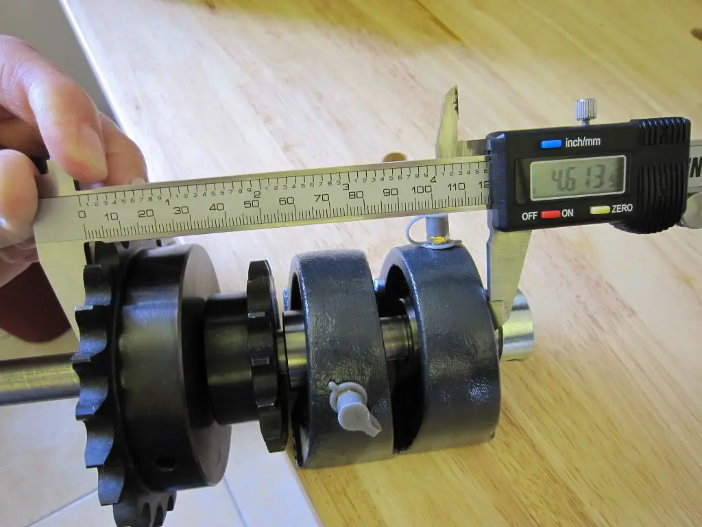

Really great build with some interesting solutions. I'm especially interested in your upside down jackshaft set up. Can you share more details about the jackshaft components and how you've assembled them? Thanks!

Esyvertson, The jackshaft setup was taken directly from the original Indian design. A similar system was also used on BSA, Triumph and Harley Davidson up to the late 1950s. The Jackshaft slides forward and back in bolt track, allowing me to adjust the primary chain when it goes slack.

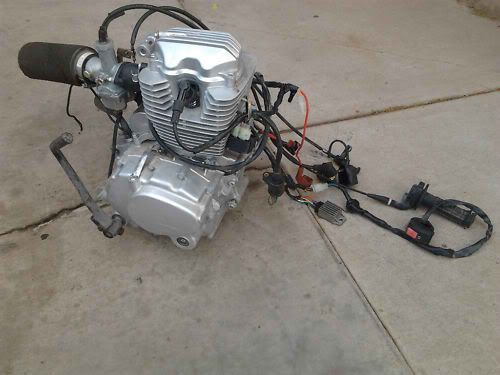

Any updates for this project? I've been following this with great interest. I've been planning for a similiar build, and planned on using the same 200cc Lifan. How do you like it? Have you had the bike up to speed before it was disassembled for paint?

I have had it up to 40mph and it handles very well. I have to change the bearings in the jack-shaft as they pivot in their races (I did not know that when I bought them). Then I would feel comfortable running it up to 60mph. I plan on changing the tires to ones with a road speed rating rather than the bicycle tires that are on it now.
