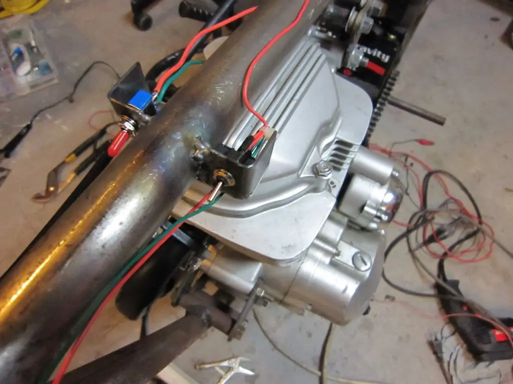

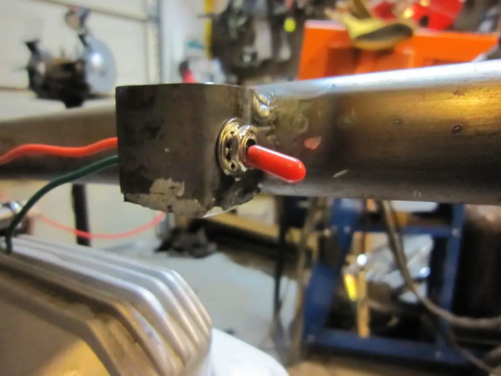

I mounted a kill switch on the right side under the tank where it is not obvious but can be reached in a hurry. On the other side is the High/low beam switch for the headlight, also easily reached but mostly out of sight. I plan to run the wire through the frame later.
[/IMG]

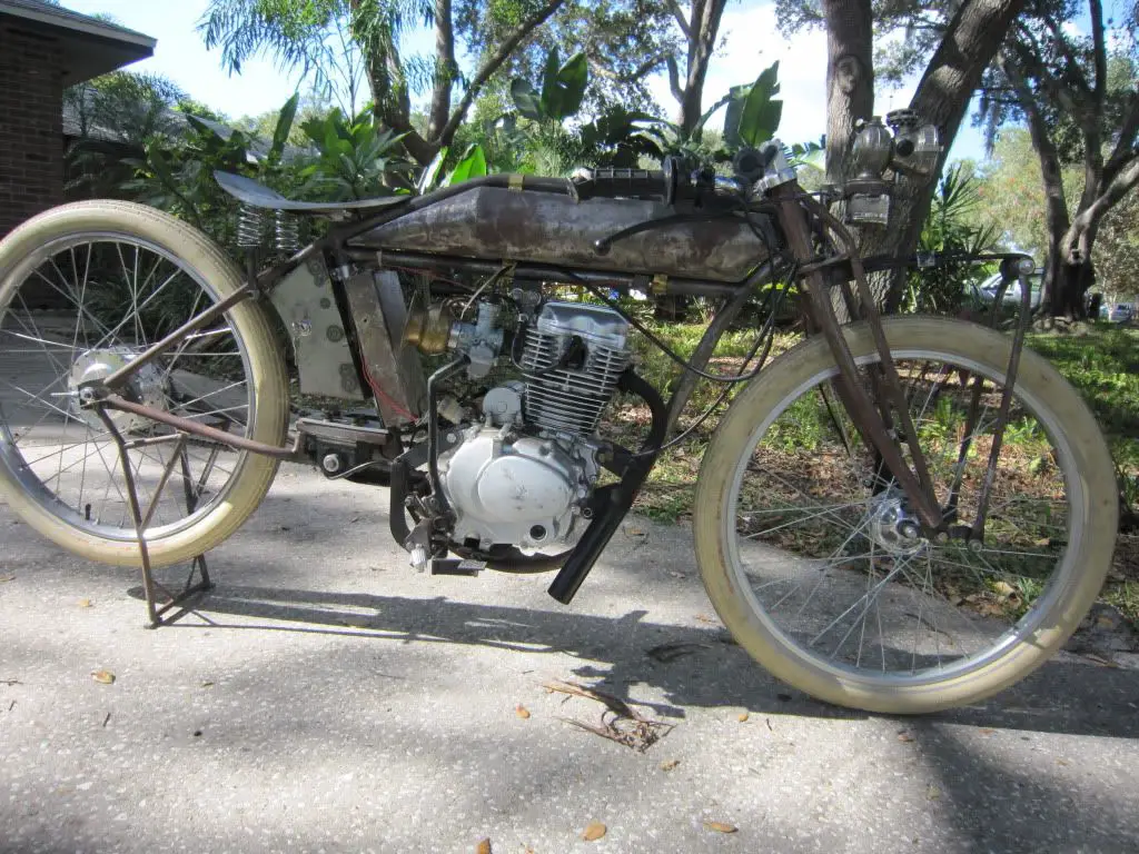

I fired it up and took it for its first test ride! The carburetor malfunctioned and the bike took off like a rocket! The kill switch came in handy; tricky business with only a front brake at this point. I put a new Mikuni carburetor on yesterday and it runs very well!

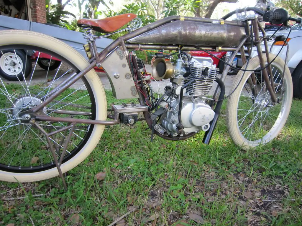

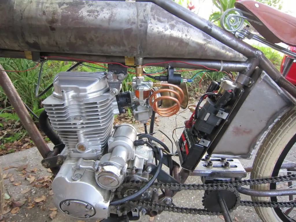

You can see the copper coil fuel line in the side view. I put sand in the line and twisted it around a spray paint can for the initial curves, then used smaller cans to finish the smaller curves. The coil serves to dampen vibration that could crack the copper line.

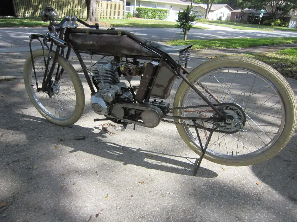

I kept the electric start, but hid the start button in the tool kit box in front of the rear wheel. The box has a lock and there will be a secondary kill switch next to the start button so the bike can't be kick started by anyone without the keys.

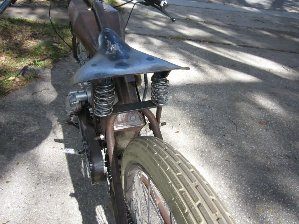

JT, here are the latest photos. I was inspired by your seat fabrication and built this one. It looks much better. I plan to follow your example covering the seat.

I just used vinyl, it's readily available at most places that stock upholstery materials and is a lot less expensive than leather. I decided to try vinyl first to see how it came out and maybe make another with leather later. The vinyl worked better than I expected and is easier to work with than the small pieces of leather I was practicing on.
