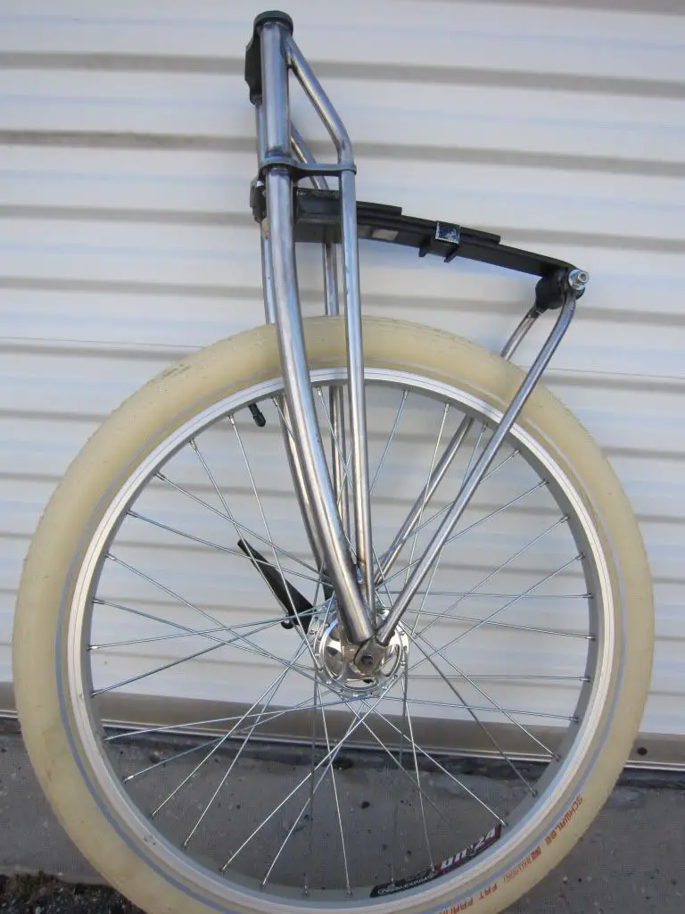

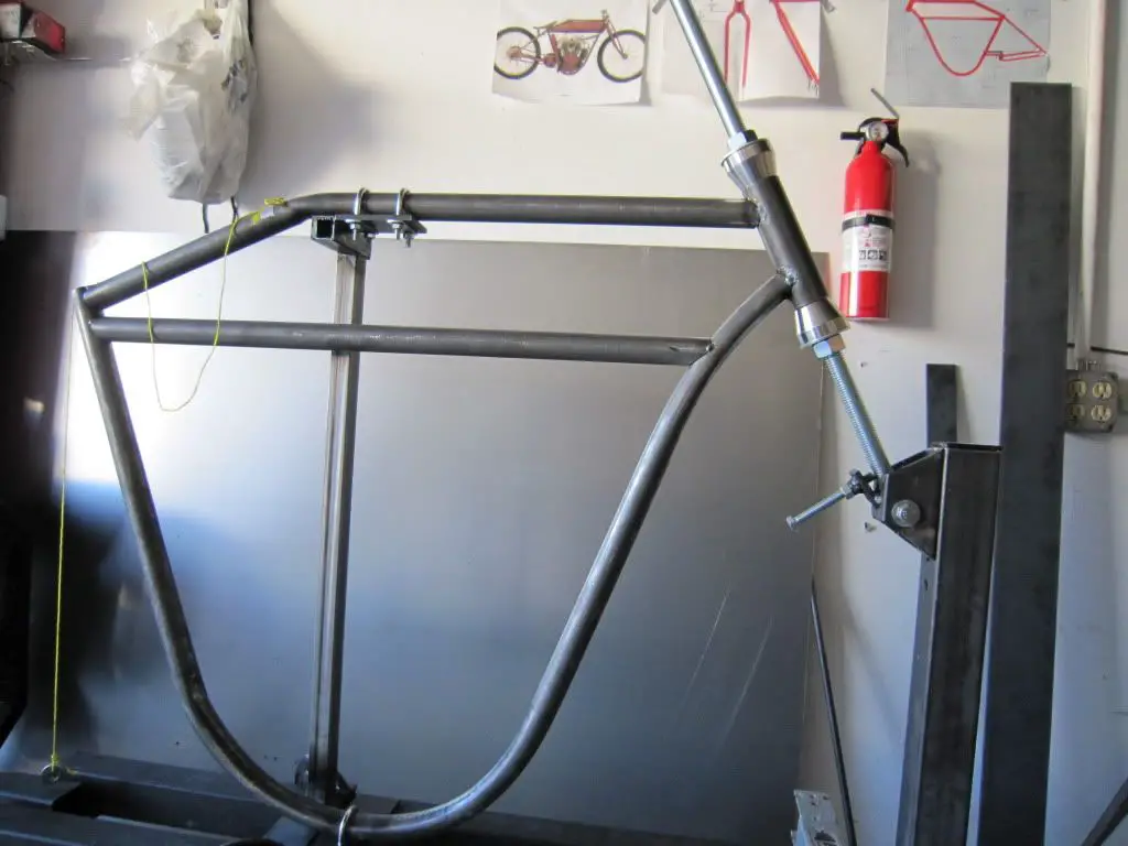

I have started the project in earnest now that I have shop space. Here are some pictures of the frame as it comes together. Dan Orabona built the front forks for me and did a great job.

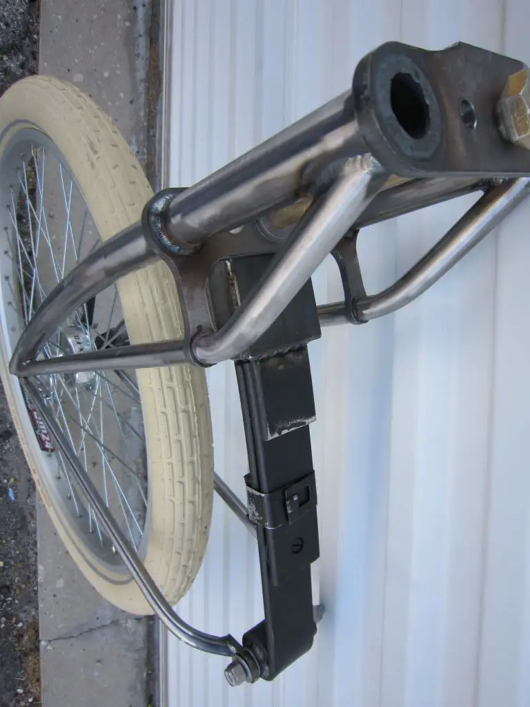

Tell us you are going to add dropouts to that front end to make it functional? That is a really nice piece of work!

Nice looking fork. It will look fantastic on the bike. Don't bother with the dropouts. The spring thickness you have is so stiff it will not move anyway. Those are automotive springs made for 10x + the weight. I'm running just one leaf like that and I put my micrometer on it to measure movement. When I go over a bump it moves about 2/8" of an inch. Not very effective, but looks great.

Yes the forks were designed to go both ways so if I race it I can pull the pivots off, but this will be a daily driver like Cobrafreak's. I am fabbing pivots with brass bushings for heavy use. I have a lifan 200cc motor with a 5 speed gearbox to go in it. It weighs about 60 lbs and is rated at 16.5hp. The engine spocket will go to a jackshaft behind the seat post with a second sprocket to the wheel. This is similar to the setup on the original.
