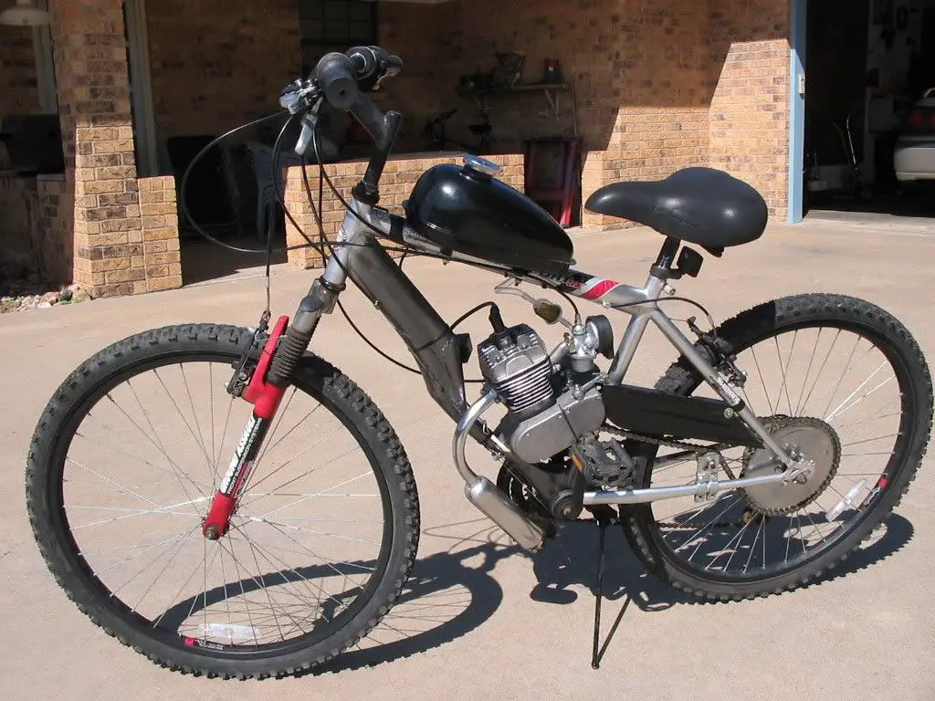

To answer your question, everything has been great. It's held up nicely. The only thing I was worried about was vibration, but it's minimal IMO. I haven't ridden enough bikes to see whether mine is more or less the same as other bikes' vibration.

Folks, has the oversized tubing issued been solved? I've read through this thread and read all the great ideas. I personally lean towards purchasing a manufactured mount. I noticed the mount by Ridley but the money they want is prohibitive. I'm hoping the Manic Mechanic will stay in business long enough to build two for me but if not, I have to find some somewere.
I have two brand new Landmarks in my living room right now. Both of the bikes are laughing at me as I tried to figure out the downtube oversize issue. It was a heck of a rise in learning just installing the rag joint for the rear sprockets! Then the engine mounts hit me with another challenge. I will persevere however.
