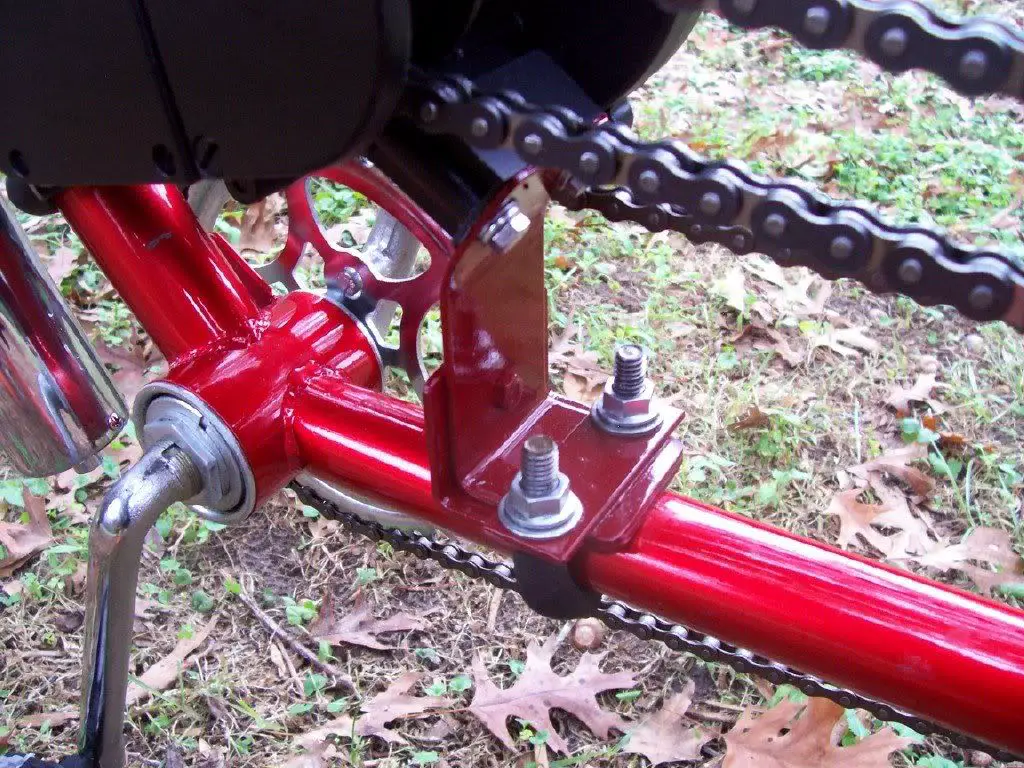

i purchased a common conduit from home depot for $1.05
Won't hold. That clamp is made of a material much too thin to hold the engine in place. It will probably crack and fail very quickly.
Find an alternative before you ride. If the mount fails under load there's a good chance you'll break the rear mount as well as locking up the rear wheel and causing you injury.

I used U-Bolts on my install and they work well. I also used automotive fuel line, which comes in various diamiters, to kind of shroud the bolt

I've been using the u-bolts for years now. When I first started out I drilled a couple frames. Looking back I can't believe how dumb I was. I'm pretty sure those frames are in the scrap pile now.
I use the single u-bolt on a lot of customer builds. I wanted something a little firmer on my personal bike, so I went with the double u-bolt. The pic of it on my bike is not a GOOD pic, but you can kinda see it.
