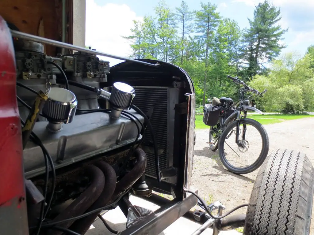

Anyhoo - I like to include pics in my posts... but none of the above would make for very interesting photos (ooh, lookit - buttons! lol) so instead here's one I took last Sunday at a friend's house, jus' cause I thought it an interesting study in contrasts heh;
