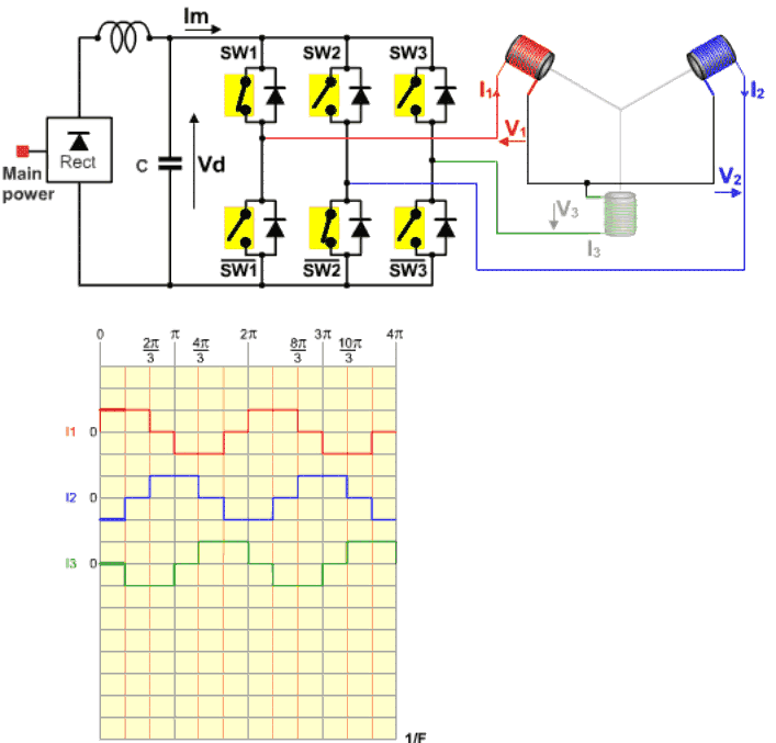

what exactly do the regin brakes do. been researching and maybe someone can put it in simple terms for me lol

Thanks ba. I thought that's what it was but read a few things that led one to believe it helps with breaking. Ebikes and all the changes since I had one many years ago is fascinating me big time
No worries Paul, I'm on a steep learning curve myself ATM lol & it does help with braking as the drag from the electric motor reduces brake load/provides additional stopping force... but one of the aspects I'm a bit hazy on is apparently the 'Pie has variable regenerative features - "no load" while coasting (no brakes) to reduce drag and I believe adjustable regenerative parameters (amount of regen/stopping force/drag) through the use of mosfet circuitry, something like this;
...but I'll freely admit I'm starting to get way over my head lol - there's more info here where I got the pic: Regenerative Braking System
From what i've been able to gather. Regen is kinda a useless feature on a electric bicycle. Since they don't have enough weight to make it effective. Other than it's a feature that should be on a checklist.
NormO
Actually from everything I've read it works
really good in stop and go traffic once you
get used to it.
It slows you down for a light so you don't
have to use your brakes and charges at
the same time.
