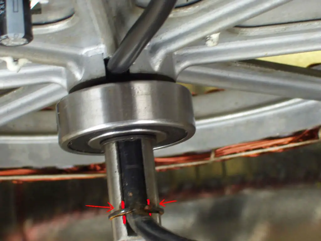

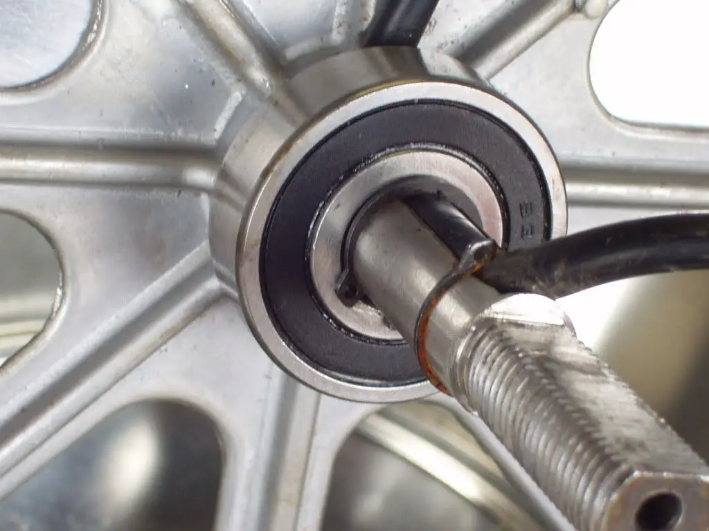

Speaking of wiring, there's another "heads up" I just remembered that may save you some headache... There's a slot in the axle for the wiring to enter the hub & a circlip/C-clip to hold it there, the edges of the axle slot are razor sharp (no joke) and will chafe through the wiring in short order, even w/o riding the bike & just messing around w/the wheel. It's a pretty easy fix if you catch it before it damages the wiring tho - you don't even need to pull the hub's cover or anything.
You will prolly need circlip pliers however, as you'll need to remove the clip to bend the wires back so you can dremel/grind the sharp lip off the axle slot in the areas marked red below;
(not my pics)
(different angle)
Again, it's simple enough & you won't need to pull the covers off like in the pics, I also added a tiny cable tie & flipped the circlip around to retain the wiring better w/mine :)
