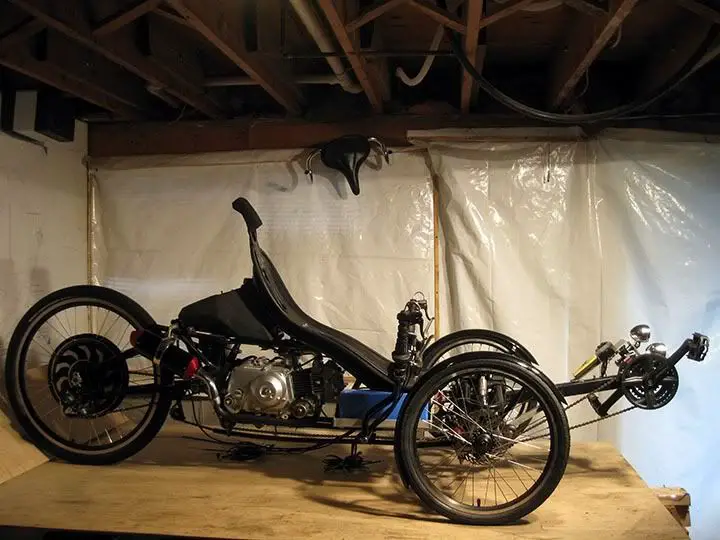

motortriker - yer so right, lemme see.... with the range I've gotten and the weight of the packs I have I'd ballpark a rough 55lbs of LiFePO4 packs needed with that setup to get about a hundred mile range - and that ofc doesn't include the additional amp draw due to the added weight >.<
Fortunately, while I have extra weight on the taddy - it didn't cost near as much as LiFePO4 packs nor does it suffer the recharge time and it makes ossum vroomie noises... while I love the silence, sometimes ya jus' need the growl :D
The Bent Zombie Tribrid Tadpole

Right ? I think it may be more about the seat.
On my trike my butt can do about 40 miles and it is wore out ! :)
With your seat I bet my butt could do 100 miles ! :)
Heck, maybe with no motor at all. Nice trike !

Thankee motortriker :D
The seat I'd gotten from 'ActionBent' one of the very few sources for recumbents & accessories that wasn't subject to the ridiculous markup recumbent parts usually suffer... unfortunately & perhaps because of that, they've since gone out of business. A shame really as they were a pleasure to do business with and had the only "normal" pricing I've seen when it comes to recumbent stuff.
Ah well... I just hope I don't need to replace that seat anytime soon lol & yea, the whole theory behind that taddy is the experimentation in trying for quiet comfort & fuel efficiency for the long hauls, extended camping trips & whatever - part of the reason for the charging dock dealie thing I jus' made is with that in mind ;)
