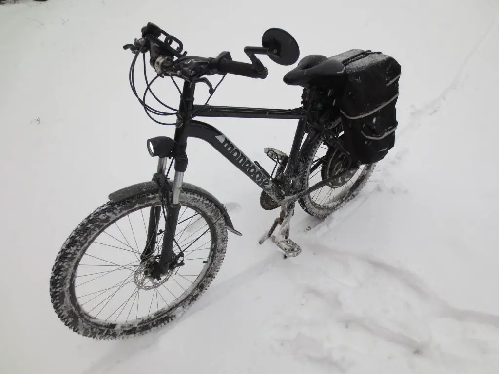

Thanks for your concern & well wishes silver & Mike! I'll not even attempt to deny the dangers of winter riding (I do after all crash at least once per winter lol), on the other hand, it isn't as bad as all that - it takes a bit to acclimatize, to adjust the riding style to account for road conditions but once used to it it's really more fun than anything else.
Sure, the icy slick patches & slush lay in wait for the unwary - but so do wet leaves & sand in any other season. The only difference is frequency. In a way the ice & snow is less treacherous as it's constant, you know it's everywhere, on every turn & tryin' to getcha whereas the sandy turn waits to ambush, the wet leaves sneaky, seemingly innocuous - until they slide yer tires out from under ya and yer laying there wondering what the heck happened lol
The cold is... well cold it's true - but I've found that with a decent pair of supple leather gloves and just my rain gear over my normal winter clothing for the longer rides suffices *shrug* I don't tend to go on my long "wanderabouts" in the winter but I'll say I'd far, far rather ride in the snow than rain no matter the temperature.
At this stage of the game (gray, wet fall) I'd just as soon it froze up & snowed than deal with this wet & sloppy, damp & dreary anymore lol
B'sides, it's Maine... if I didn't ride in the winter, I'd hardly get to ride at all :p

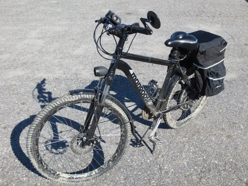

Well, I s'pose it shouldn't be a surprise... but after putting the new knobblies, fenders & center stand on, gobbed a lil dielectric grease on the connectors & sprayed anti corrosive all o'er the place w/abandon...
...I'm filled with meh
Granted, everything did exactly as it was supposed to & TBH I'm loving this center stand... but after I hunted down some puddles to play in, tearing down some trails covered in wet pine needles, leaves & muck & then going for about a 20 mile ride I can safely say the fenders & tires both also do their jobs really well - but I also really miss my "old" bike already.
On clean, dry pavement - the tires howl like banshees, once rolling at speed they drown out the sound of the electric motor completely, the occasional pebble picked up ricocheting up & under the fenders like a sudden gunshot out of nowhere. I've lost 1.5mph overall and the turns are made of marshmallows. Then there's also the oddity that for some reason I really liked how it looked with dirt fenders & street tires, but street fenders & dirt tires? More meh... it's just plain weird lol
Whatever, it's not about looks and "clean, dry pavement" will all too soon become just myth told while huddled around the woodstove, a tale to tease as we bundle up for the blizzards. Much as I may be disgruntled now I think that'll change quickly enough once they're needed. Even during yesterday's run, after blasting through some puddled mud & muck, I looked down with satisfaction at my dry shoes, my clean pants, knowing had I tried that same turn with the street slicks I'd have been face down in the puckerbrush, my bike in a heap a little further down the trail.
...I just may put the semislicks back on in the meantime though lol

All decked out & ready for winter - I'd just washed it the day before believe it or not lol but hadn't quite finished the lighting (thus the unsightly wires);
As it gets dark sooner & stays that way longer in the blasted winter wasteland, lighting becomes no longer just an accessory but a critical necessity. I've lighting on all my builds ofc, but as Mongo was just a "temporary" experiment I'd never refined it's wiring - particularly the switch for the 48 to 12v converter, which also served as the only way to turn on & off the (12v) lights. Hidden away, stuffed deep in a nest of wires this worked well enough for the occasional night ride, but it was a pain.
Given I had to completely redo all of the wiring anyway to change out the panniers & due to the relocation of the batteries - I finally got around to adding a switch for just the lighting, a minor thing to be sure but another I'd put off for too long lol - note, the corrosion & tattered paint on the rack clamp isn't new, I'd "recycled" that rack from my poor, whipped Schwinn which had thousands of winter miles on it;
