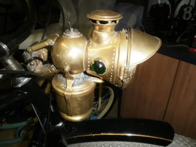

I have also acquired a couple of Lucas carbide lamps. This is the first one
This is the second light that I think I will use for the headlamp. The other one may get a red lens and become a tail lamp.

The front fork is going to be nice. I love the lamps. Yes, the second one will make a great headlight. Nice little hood on there.

Awesome defanet like the second light polish it up be kool. What are you going to use for the pivist and bushings? I am useing drill rod stock from www.use-enco.com I will cut them to close length put them in the lathe drill them for bolts the trin then to the finial lenght. Heat them red and toss in oil a lot cheeper then scholder bolts.........Curt

I have the same headlight as your second one, though yours looks to be in better condition. I will however advise you that the rear of the 2 top covers can come loose, i actually lost mine on a ride, but i replaced it with a washer and switch for the LED light i fitted, so its not too bad. But you may want to look at fastening it somehow, if you havent already

Harry76, Thanks for the heads up on the cap. However I think your lamp looks better than mine, The chimney on this one is slightly cooked.
Your is way better then mine, did you notice where someone has repaired mine between the upper and lower section.
I didnt even notice the "cooked" chimney until you pointed it out, is it obvious in person?.... A man of your talents im sure you could straighten it up a bit? Or will it break do you think?
It is fragile, but that is ok, I won't attempt repair, this is not going to be a shiny bike.
More like it was just dragged out of a barn.
