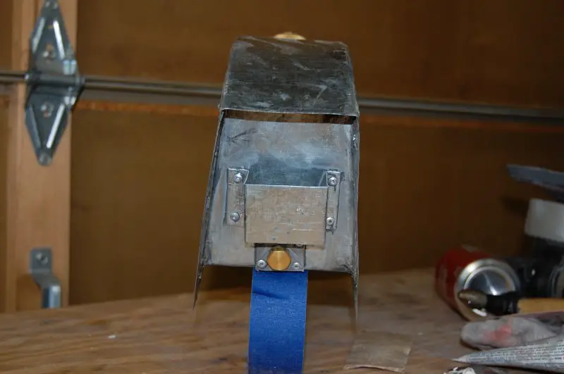

Got the new gas tank and oil tank that I'm mounting on the bike finished up and fitted. Needs to be painted and the three tanks need to be lined with the tank liner probably tomorrow. The body work on the tank is where I filled in the spot welds.

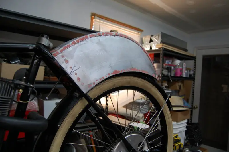

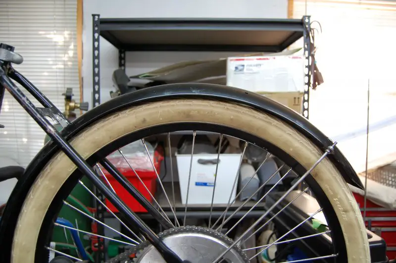

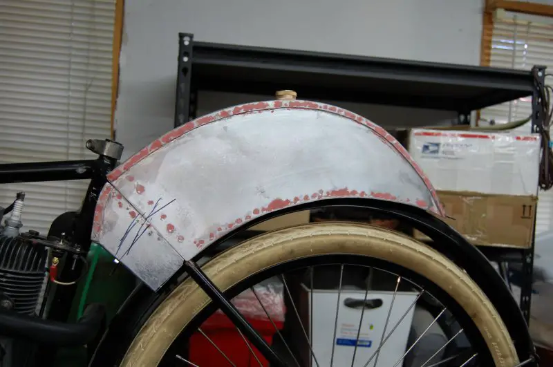

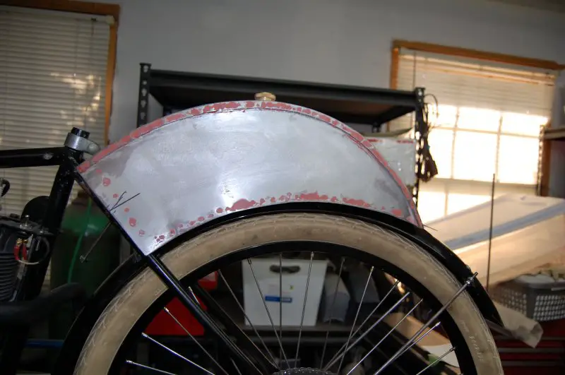

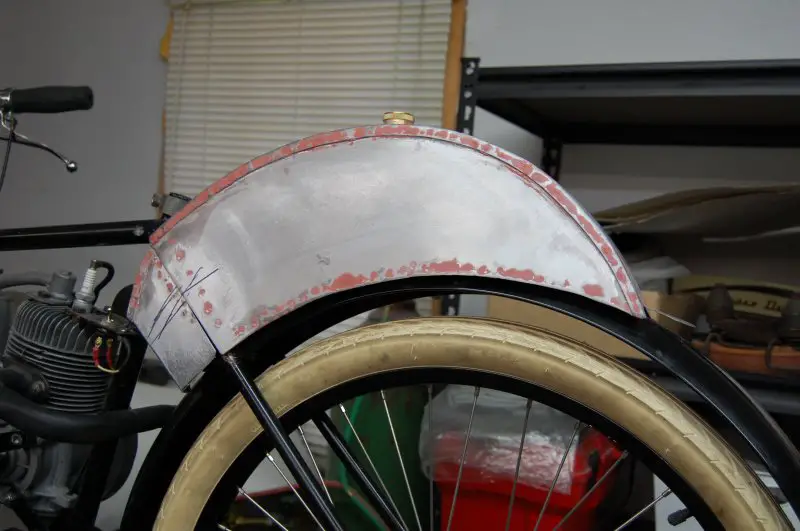

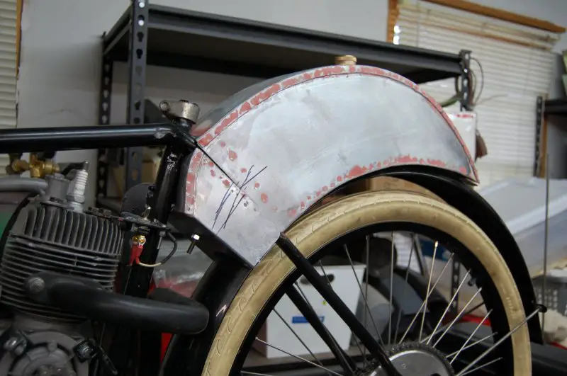

The back fender has never seemed right to me and I looked at photos of the original bikes. The fender needs to be bobbed off and the rear fender support should be at more of an angle. There was too much space between the fender and tire as well so I loosened the fender mount and lowered it and it looks much better. I'll finish that off tomorrow as well.

Fender is bobbed like the originals and the fender support is as close to the original angle as possible. The original 28" fender provided more space. Since I started moving everything on the fender nothing of course lined up so it all had to be rebuilt.
If you look at the photos above this you will be able to see the changes I made if you compare them with today's photos.

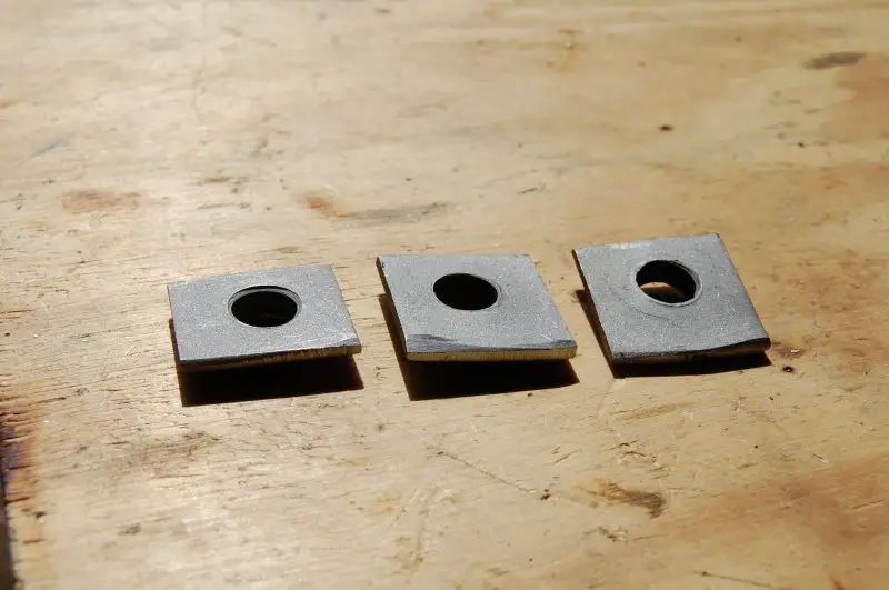

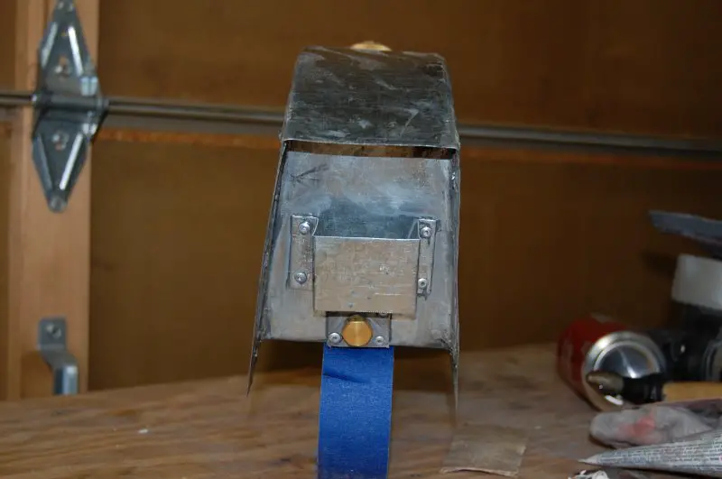

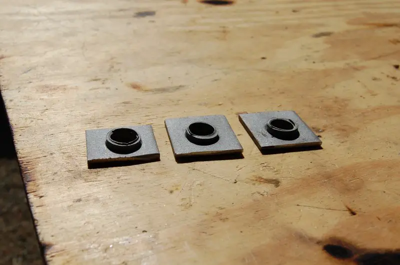

Top photos are the inserts for the gas line outlet. Drilled a hole in 1/8" x 1-1/2" flat steel and welded in steel tubing and sanded the welds flush. Then I threaded the tubing. Predrilled the rivet holes and bedded the outlet in slow setting JB Weld and riveted it in place.
Next. The fender bobbed and then lowered closer to the tire and the fender braces angled.
Next. Just to show what the tank looks like. The mount for the bolt that goes through the oil tank is riveted and bedded in JB Weld. From 1908 on I believe they mounted the oil tank as a round canister on end behind the seat post and in front of the fender There was just a plate on the other side of the seat stays that a bolt passed through to secure the gas tank as well as the fender mount on the rear of the tank. Brass plug is just there for the tank liner to hold it in.
I put a rivnut in the bolt mount for the 1/4" bolt.

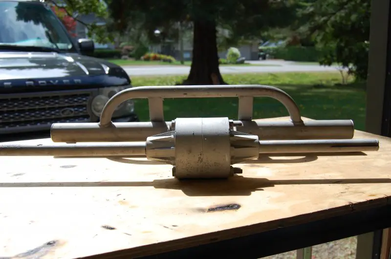

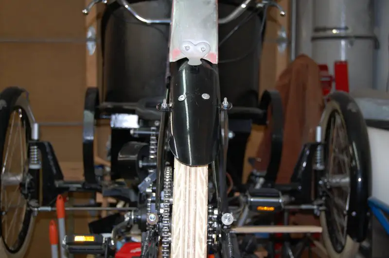

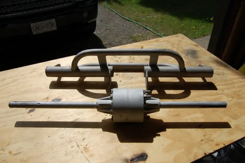

Last photos. Curt sent Silverbear and I some lawn mower trans axles in 2014, I think. Rooting through the trailer I found it and wondered how it matched up to a trike rear axle I bought from Chain Maker long before that. Ran it through the sandblaster to clean it up. If it ever gets used I'd use the trike rear end as a guide to make one for the lawn mower rear end. Make the trike rear end so it splits in two and the differential can be removed.
