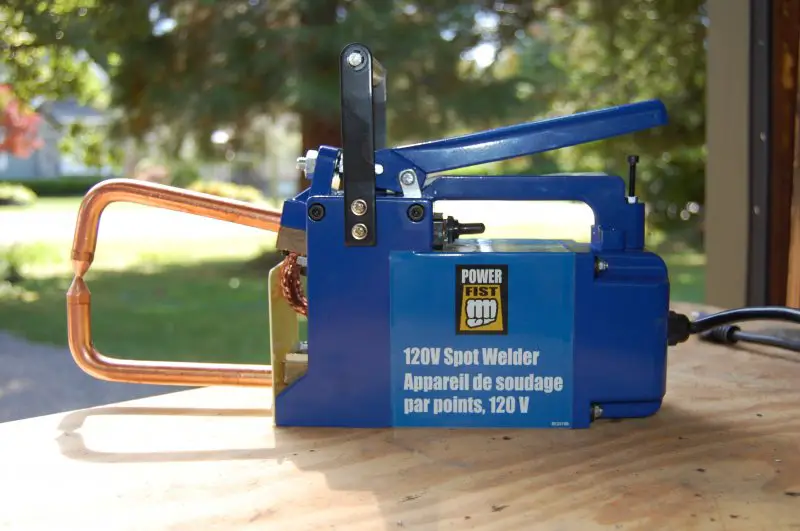

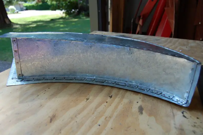

The gas tanks are together. I took the easy way out and spot welded the last two. I bought a 120v spot weld on a clearance sale at Princess Auto, Canada's Harbour Freight. It cost $118 Canadian or $89 U.S. I've had it for a while and hadn't set it up. For a cheap welder it is surprisingly powerful. Much like the one Harbour Freight sells.
I just spot welded the bottom and front of the gas tank in place. I'll solder them up in a couple of days. Canning season is upon us and I'm the prep guy.
They recommended sanding the tip on the spot welder every 4 welds since I was welding galvanized steel.
The zinc contaminates the copper so some 180 sandpaper wrapped around a paint stir stick cleaned it up nicely.
Now it's a wait for the tank liner.

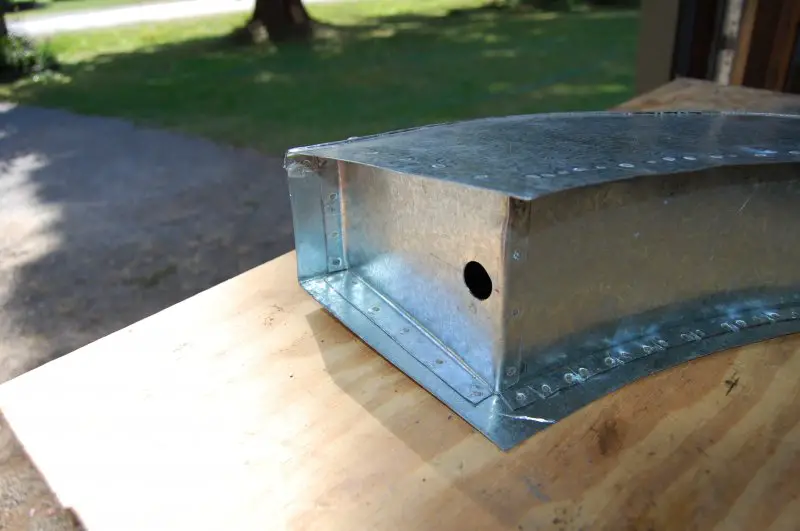

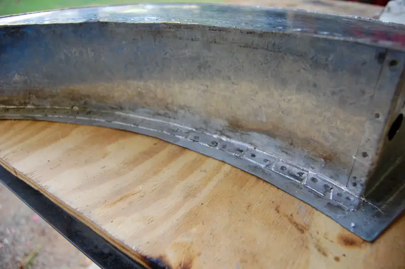

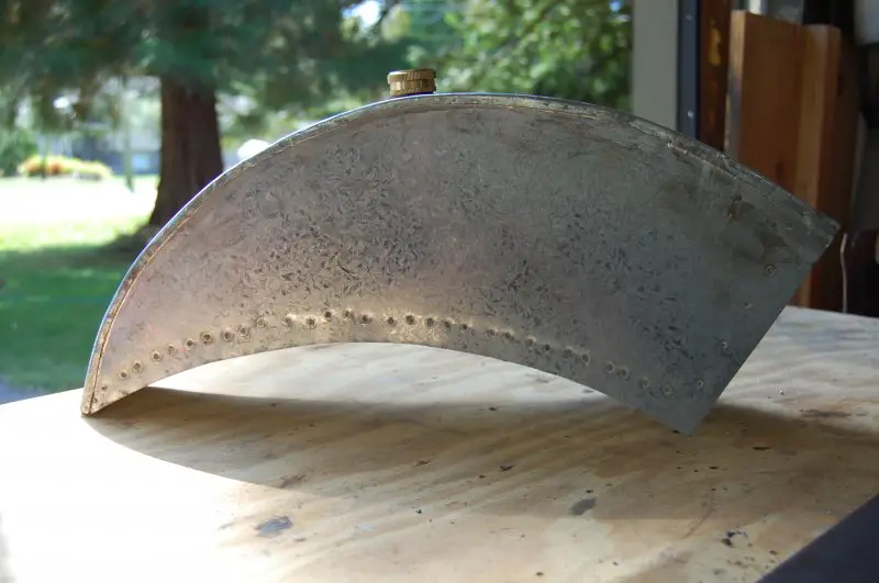

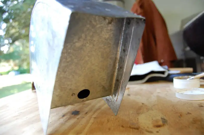

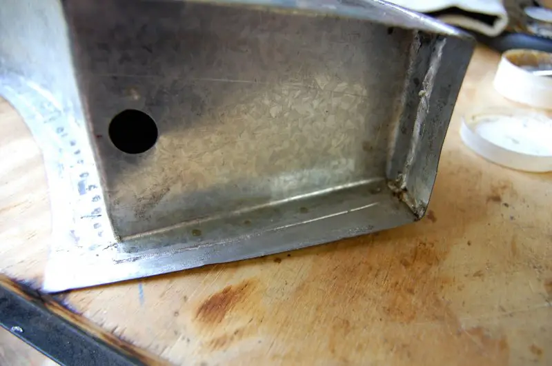

Tanks are soldered together other than the tail piece to mount the rear of the tank to the fender and the gas outlet. Have to do a soapy water test to check for leaks. Spot welding them together made the last two go together much more quickly.
Here are some photos.
Steve.
Steve.
Triplets are normally slow delivery Steve. That's a lot of work to this point on the tanks. In the old days galvanized metal & paint weren't the best of buddies. Have you decided on a modern paint/filler that will hold to galvanized metal? My knowledge of painting is extremely limited and on cars, trucks and motorcycles I've relied on experts to finish my mechanical creations and my bike builds normally get very little paint and that being black...
Rick C.
I have primer that was made to bond to galvanized metal. In the past I had some interesting and not happy experiences with paint making it's unplanned escape from galvanized metal. I went to our local auto supplier and bought what they recommended. Supposed to hold onto galvanized metal like the taxman onto your pay check.
Steve.
