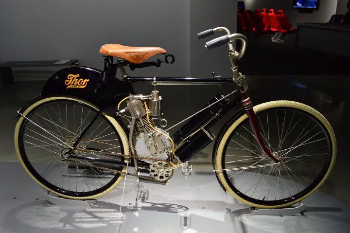

I was wasting my life away looking at Thor motorcycles.
I was raised in Batavia, Ill. about six miles up river from Aurora, Ill. A Tool and Die Maker, Ron Lundquist I worked with 40 years ago. Rode a Thor as a teenager i.e. pre WW II and after the war rode Harley for years. Thor made the first Indian engines. Owner unknown rebadged a Camelback.

I had seen Indian looking Thor's but never linked the two. I wonder what caused them to stop manufacturing motorcycles. Economics maybe? Wasting you life away looking at Thor Motorcycles. I would prefer to look at it as enhancing your personal knowledge of vintage motorcycles.
