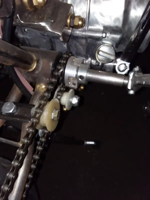

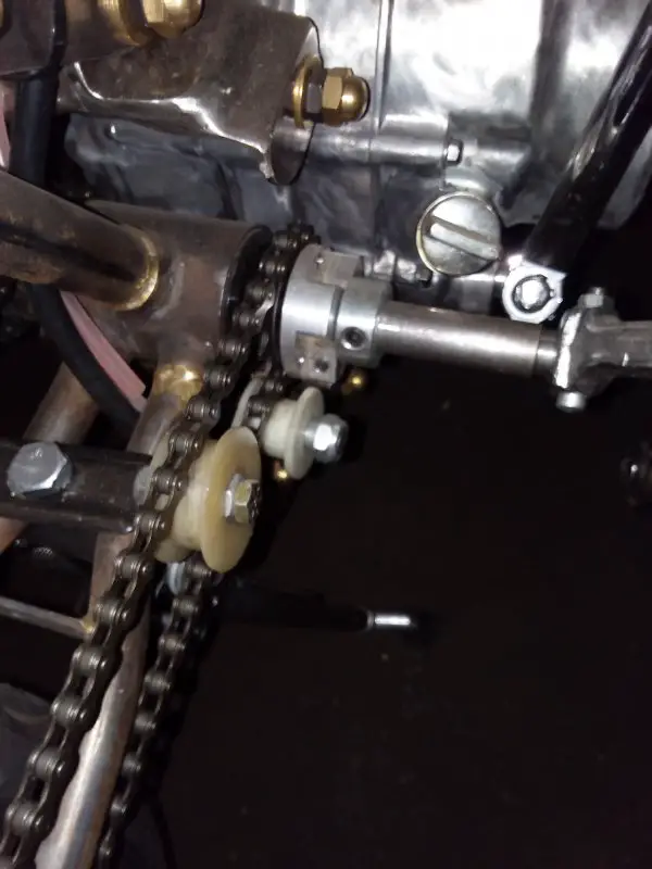

Thank you. I have Pat's pedal crank set. What I need is one side of the shaft extended 1-1/2 inches from the stock length. This will allow the pedal to fit. That is 1-1/2" from the C clip. Pedal, cotter pin notch would be as Pat made it.
I'll post photos to show what I'm up against.
Steve.

Steve have you looked at the possibility of just moving the bottom bracket shaft the required distance to mount the pedal lever & installing a spacer bushing between the clutch & bottom bracket bearing to maintain correct spacing? The shaft axle snap rings would be eliminated on both sides of the bottom bracket so a split collar can be installed on the pedal side of the axle as well to keep the axle in place. The pedal side components could then be reinstalled and no machine work required at all. This will work if the pedal lever on the pedal side has enough room to clear everything & if not a session with the torch can bend it into compliance.. Chain line on the pedal side will almost certainly be altered some as well, but shims or bushing will do quite well, in place of the split collar on the pedal side, where adjustment is relatively non critical compared to the clutch side. The only thing required on the clutch side is to loosen the split collar and adjust enough to allow the pedal lever to be mounted. Install the split collar properly and then shim the shaft between the clutch & bottom bracket bearing to maintain the correct chain lines. The simple removal of both snap rings is the key to making this work. That and having enough shaft length on the pedal side to work with and if you're using Pat's 3/4" bottom bracket shaft and pedal drive components you will have plenty of length.
I've been riding the Harley Peashooter set up this way for two years and no problems encountered by eliminating the snap rings. Do this and you'll have the problem solved before the New year. Or you can have a new shaft machined, just cost more and take longer...with no improvement in performance.

Rick made a good point, adding two new snap ring grooves 1.5" offset might work. either way another tear down is in the offing. You would need to extend the key way for the pedal sprocket also.

Tom my pedal side keyway has more than 2" extending past the pedal sprocket & collar. Perhaps different runs of shafts were machined differently? At any rate patience with a Dremel & fiber cut off wheel can extend the keyway as required. I've not seen a need on my setup for the snap rings, just need to them shim properly. There could possibly be a little wear down on the shims given time, but I sure haven't noticed any to this point. If they eventually wear it's a quick & insignificant maintenance item. Much easier than periodic setting of valve lash on an 4 cycle engine. With the lock collars on the outside of both the clutch & pedal side of the shaft there is no place for the shimmed & keyed components to go.
I've ridden this setup for quite a few miles with no sign of any problem and this being driven through a 5 speed 125 cc.with 5 times the torque and hp of the tricar.

This is why you and Tom get the big money. Shuffled myself out to the garage and looked at the pedal shaft ect. If I remove the C clips and move the shaft over to the left I may be able to gain what I need. My measurement of what I needed was generous to say the least. Probably 5/8" will work.
Looking at it today from the right side of the shaft I can see that a half inch plus shift to the left would probably clear the area where the pedal mounts.
There is a 1/2" of key way left that the pedal sprocket key isn't using. With the C Clips removed I could slide the pedal shaft to the left and gain the space needed.
I see what you did in the photo you included and it is the same as what I have. I'll shift the pedal sprocket out towards the end of the shaft and add a split collar. I happen to have a fine selection of them. If buying one's good what can buying 10 be but ten times better.
I have some 3/4" bronze washers and I'll try and use one as a shim between the pedal sprocket and bottom bracket bearing.
I didn't receive a bearing spacer with the pedal crank but I'll put one in when everything is apart. I'll add photos of what the right side of the pedal shaft is like.
