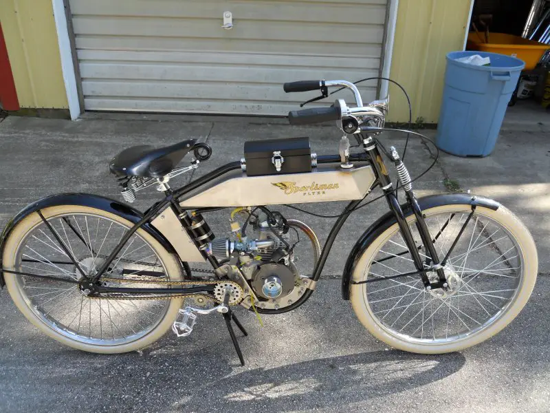

Being serious though, your Sportsman's looking dapper. Bet it was a kick getting aboard again after winter lay-up. Looked like a nice day for it in the pics. Made me hanker after getting my Indian boardie tribute out of storage - which isn't possible 'cause the unit is presently closed like everywhere else.
Being a dyed in the wool leg man all my life, suspenders have a whole different meaning to me. But then, here we go again, you'd call those garters, no?
Had the Sportsman out for a brief run Wednesday Pete, a bit chilly but my Brando hat kept my hair warm.

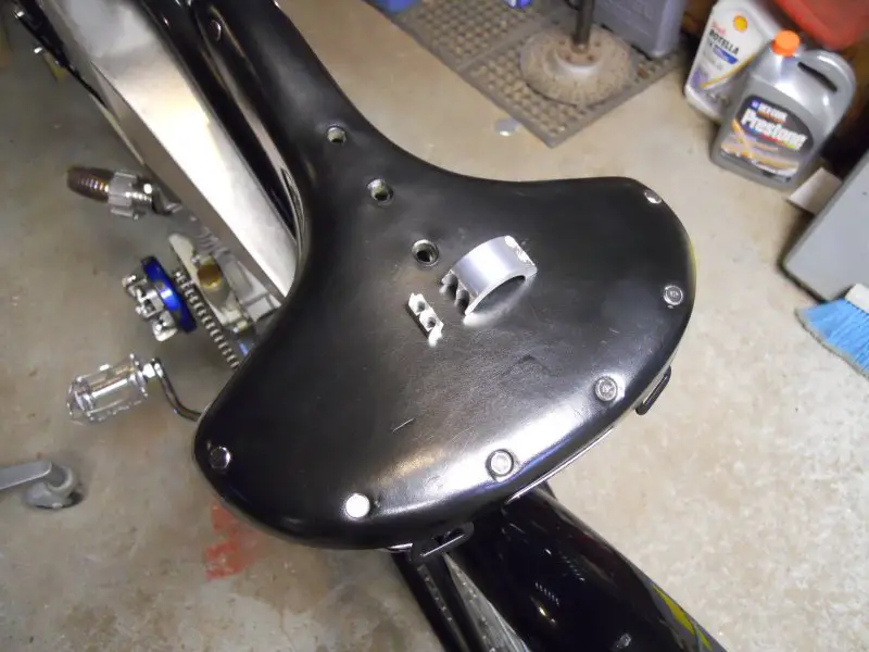

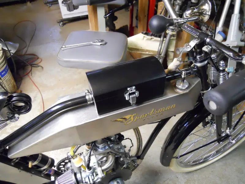

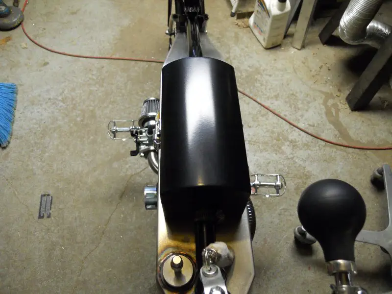

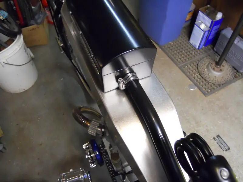

Clamps I made for the Indian tool box failed. Likely cause, using too big fasteners in for the limited area of the clamp parameters and also counterboring for the SHCS was the kiss of death. In retrospect smaller fasteners would achieved my goal. What a waste of precious beer drinking time;). Fear not beer was always present and may have affected my judgement. Having a competent person checking my work could have helped, but then I would have had someone else to cast blame on. In the end it was my own Ham-fistedness. So it was suggested some time back that I use worm gear hose clamps.
I Quailed at the thought, but no more.
Tool box is mounted securely. I'll get over it, it's not like I haven't used hose clamps on this Sportsman 80.

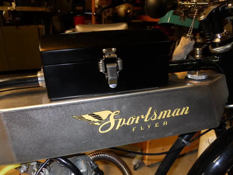

Don't know if you can see it but the U shaped pull that draws the lid closed is spring loaded.
At first I didn't know if I liked it. The springs do allow a bit tolerance to mounting hole placement and also keep the lid under constant tension. On our rough secondary roads the tool box produces not rattles.

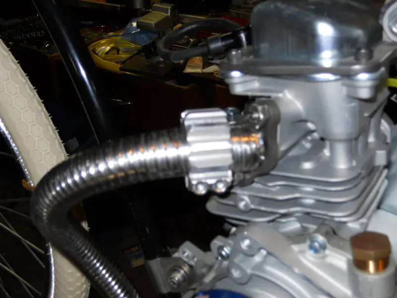

I think it was Scotto who ran a breather out of the oil fill on a bike..not sure if there was a can attached or the filter was up real high...I ran one out the breather..the only compete full day of riding this summer and was surprised how much oil maybe 3oz. Tom..where did you get that 1" exhaust clamp.
Made it in my machineshop, assuming you are
referring to.
