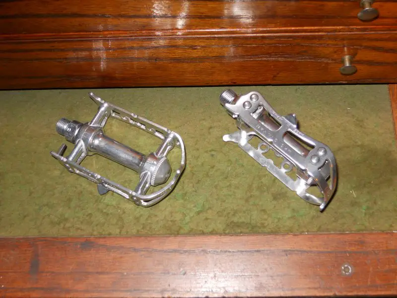

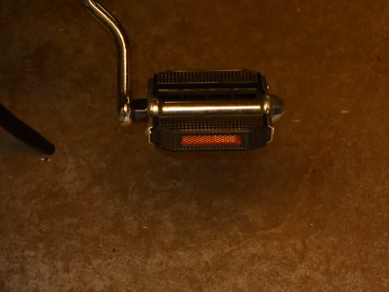

I have been unhappy with the generic pedals on the Flyer for some time, Walmart I think but other things always got priority. The bike being a tribute to an earlier time at the dawn of motorcycling the more period correct details the better.
Bit of searching, likely candidates varied in cost from nearly $450.00,https://www.ebay.com/itm/Antique-Ha...473765?hash=item3fe03474a5:g:O4EAAOSweateoDyJ
Beautiful!
But what I settled on which are beautiful too at less than a tenth the price.
So nice I am thinking another set for my 1972 Schwinn P15 Paramount.
https://www.ebay.com/itm/MKS-Sylvan...dals-Silver-9-16-Alloy-Toe-Clip-/323935806365
That the seller is in Mount Horeb, Wisconsin sealed it.
They came today and will soon grace the Flyers pedal cranks.

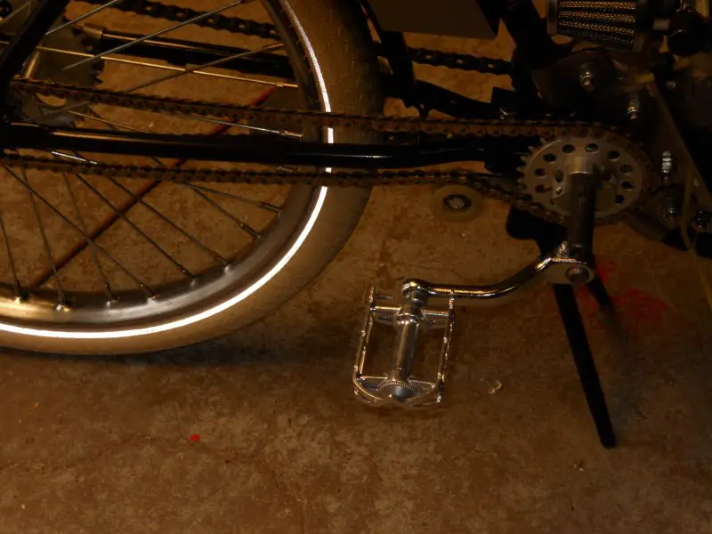

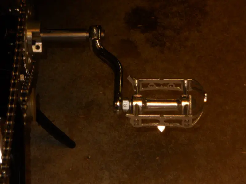

It finally dawned on me where the pedals on my Flyer came from. In a moment of shameless expediency my Huffy - Davidson pedals were pressed into service.
Shame for shame and Egad!
Before and after photos on the install. Tomorrow I ride.

The new Rat Trap pedals are nice to look at but I have found that they don't remain in what I will call the upright position. The pedal body is not centered on the pedal shaft. I'm going to have to come up with some sort of counter balance that doesn't look too dorky.
