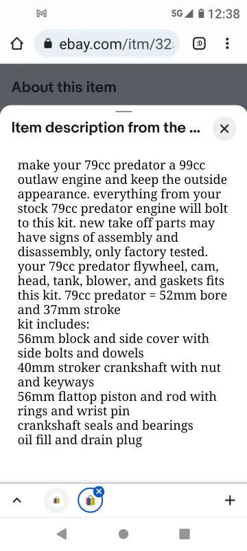

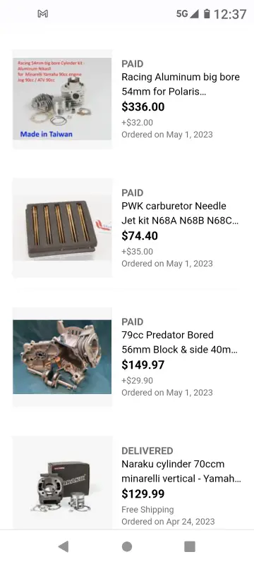

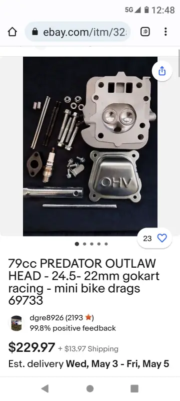

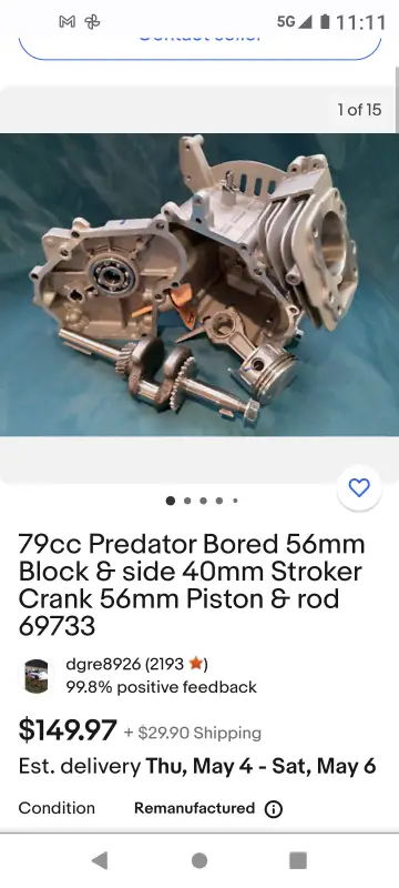

This is what I'm working on 79cc ... Degree8 on ebay has your parts.. pwk needle jets ;)

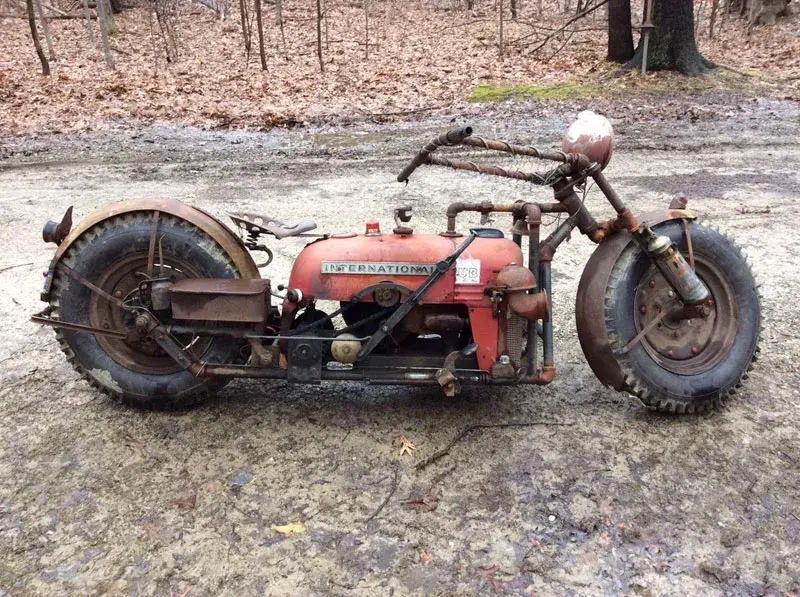

Tony, here is a link to the origin of this lovely adaptation of a Farmall Cub Tractor.
Guy Turns Old Tractor Into Badass Motorcycle » TwistedSifter
I think the oil can mounted behind to tractor tool box is what makes this build so right.
And you can get a rusty butt from the heavy duty saddle. As far as the frame is concerned?
I suspect it is a low cost proof of concept prototype. ;)
