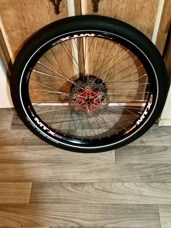

I decided to simply drill out a MTB rim and hub to accept the 12ga spokes and spoke nipples. Double wall eyeleted rims are a pain to drill out though, especially when the eyelets are staggered. You have to drill those at an angle, and they like to spin if you're not using enough of a high quality cutting oil with sharp bits. The hub is easy, you just need to make sure you have some oil and you gotta clean off the bit every two or three holes and apply more oil. And let's not forget, slow and steady makes a clean cut.
I'm actually about to start truing the wheel and getting it tensioned up. I'll post a photo with the tire on it once it's complete.
Only thing I use on all my bikes is 12g spokes and steel rims. I just but worksmen rims now 1/8 thick rolled ones. Weight makes no difference to me in th he end like most have a melt down over lol. The bike has a engine I always say!
I used the rim I did because of the strength, though I am glad to shave off some weight. It'll help my bike accelerate and stop faster, and might even let me go faster. This is a 33mm wide rim too, so I'll get a nice profile on my tire, and I won't suffer from tire squirm as much so handling will be more responsive. Here's hoping it actually holds up under tension.
Here's the completed wheel
