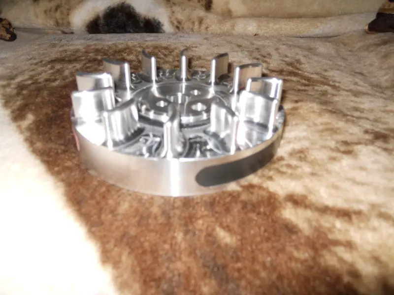

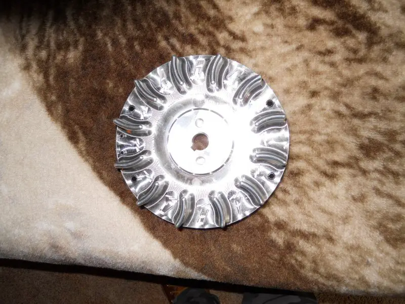

The only other extreme and costly mod I am doing, is replacing the cast iron flywheel with a ARC Racing billet aluminum flywheel. Keyway cut to a extra 4 degree spark advance totaling a 28 degrees of advance.
Today the ARC 6671 flywheel came by post. It is a CNC machined thing of beauty. Embellished with engraving which will
be unseen as I will be using the pull start blower housing this time around to take advantage of the finned flywheel.
Couple of poor photos. I got a pro photog buddy. Where is that rascal?
