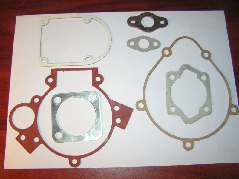

All new gaskets:

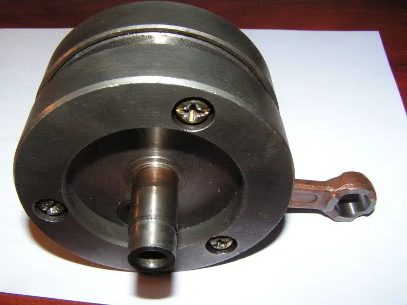

The rod/roller bearing/crank will be replaced (have a little clearance in the roller bearing)

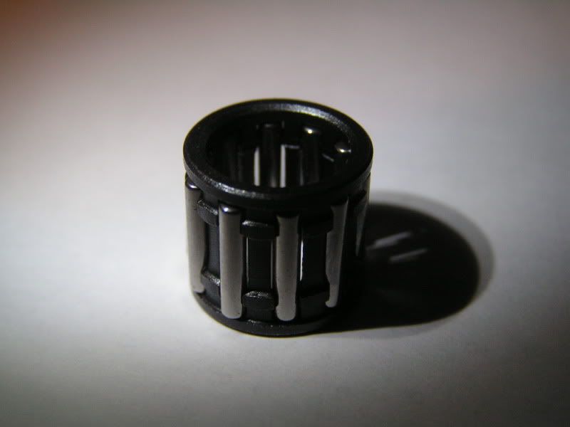

A new really high quality piston/rod roller bearing, made by SKF:
Ooooooo! Did you actually find the big end bearing made by SKF or is that for the small end?
This is the roller bearing that connets piston to the rod. This roller bearing is the big problem in these engines. If broke at high rpm's..you know what happens :(
OK, so it's the same bearing as the INA I listed, only made by SKF.
If you don't mind me asking, what's the SKF number for it?
I know that most bearings are marked with universal numbers, but depending on the manufacturer there can be subtle differences.

All new gaskets:
Jus' a tip that ya may have already thunk of - ya might wanna carefully trace out all those gaskets onto a sheet of paper as templates, save ya a bit of fuss and bother should ya ever need to make yer own ;)
