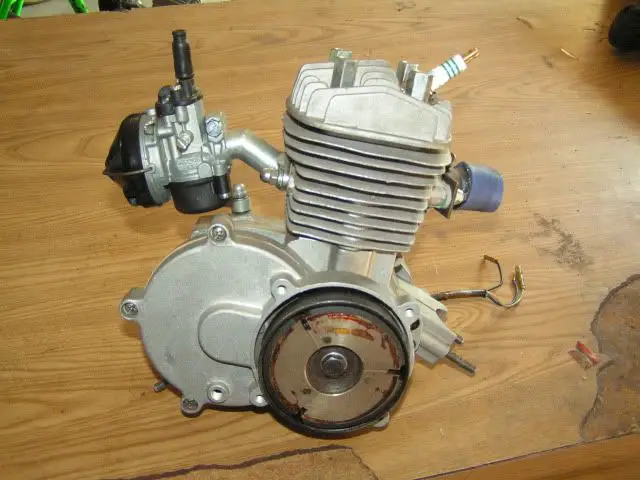

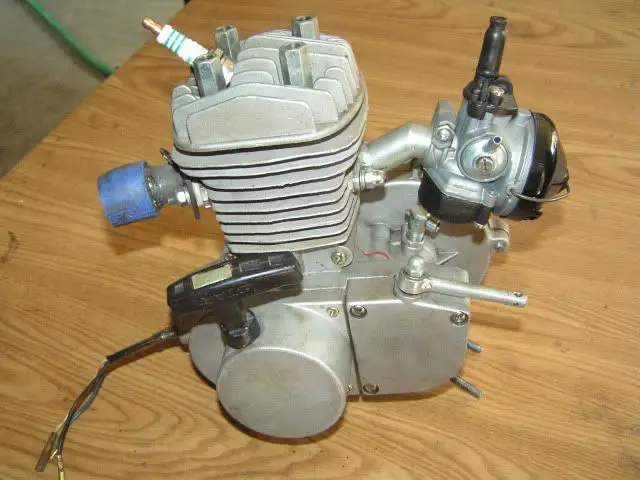

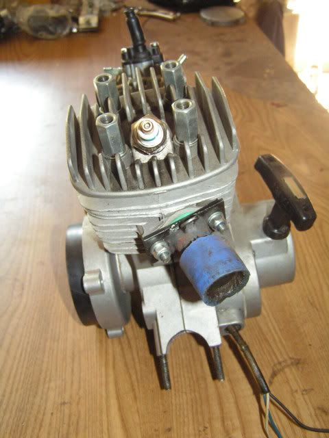

The engine is complete now, i will take some pictures and post here! ;)
Here you go guys!

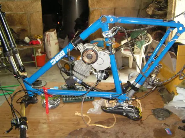

Updates!
First cold start soon!

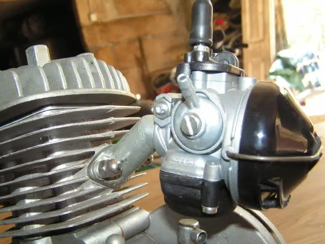

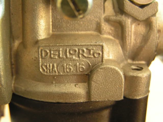

And the carburetor is not tuned yet :) Only installed the old main jet of NT carb, #70
thank you, i'll keep you updated!
