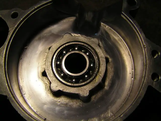

Crankcase polished (not mirror finish because of hard work location, but its pretty smooth :) )

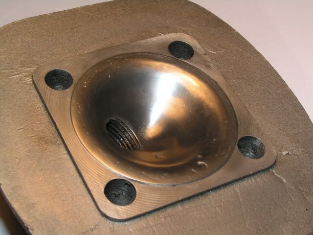

The engine is already mounted. Im going to polish the head, and mount the clutch part and magneto,
Some photos soon.
Cant wait to put this little beast in the road

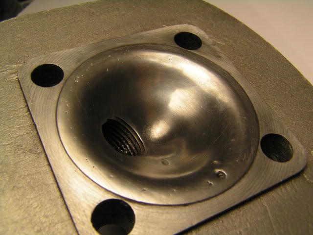

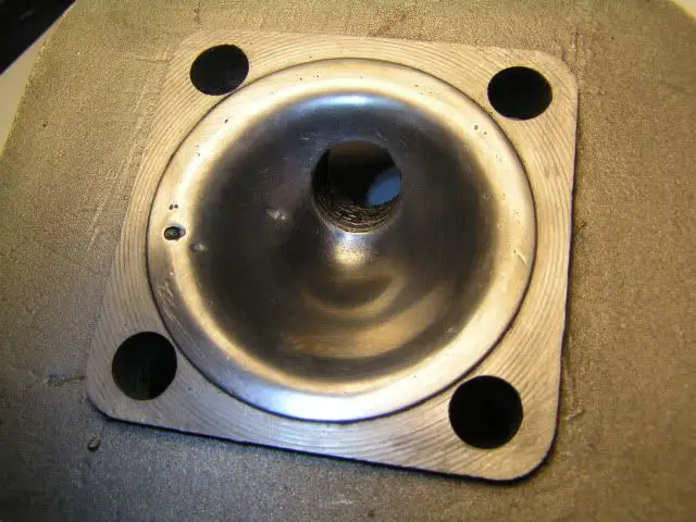

That will improve the travel speed of the flame front, help reduce the formation of carbon buildup, and reflect more heat down into the combustion chamber while slightly reducing the temperature of the cylinder head. As for increasing the combustion gasses ability to flow to the exhaust port, no it won't really do that.
The pits left in the casting from the factory will accumulate carbon buildup and lead to hot spots which can cause pre-ignition; especially that large one near the edge, right in the middle of the squish band.

whats the benefit of smoothing out the crank case

That is really sweet! I think the benefit of smoothing the crankcase is that the gases move around smoother and it might help with lubrication too, I don't know o_O...

Yes, that polish in the crankcase will increase the speed the gas flows.. ;)
