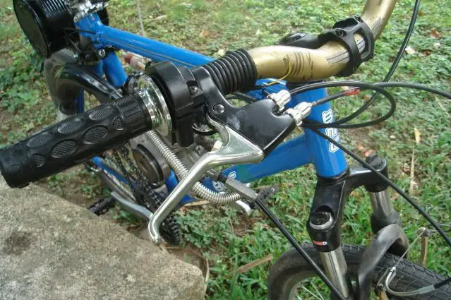

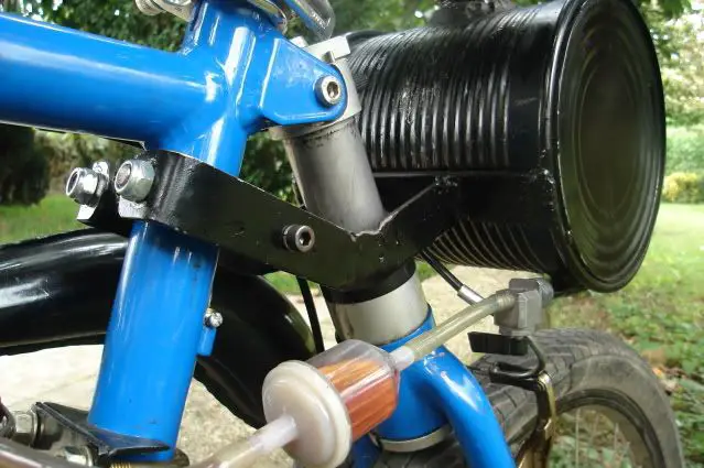

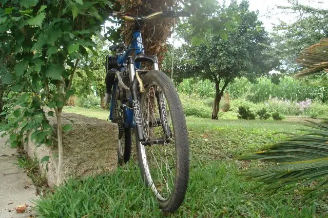

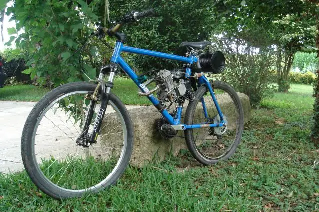

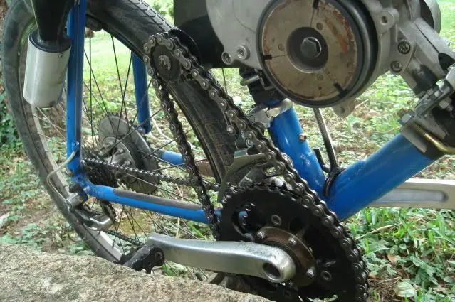

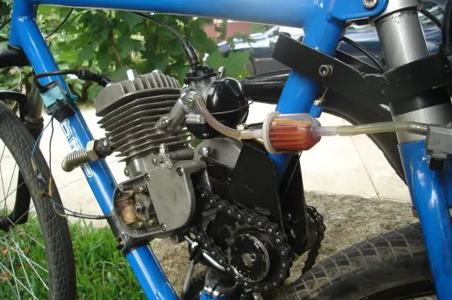

Went for a little run yesterday, and this beast has so much torque...gourgeous
Did 67km/h down a street with no much throttle, but the acceleration is the bottom line of this engine.
At the moment, need some re-adjustments, and then its ready for some street action.
Have to do some vids :D
