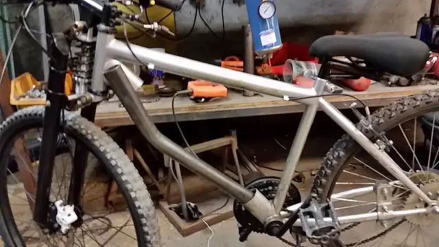

Today I cut out the bad section of frame on my mountain bike and bent a new lower tube for it, the bend isn't too drastic, but should give me at least another inch of badly needed engine clearance... Before, my engine sat in there so tight that I had to pull the engine to remove the carb or even to remove a spark plug... I'm trying to get enough room that I can pull the head or the carb... or both with the engine still mounted in the frame...
Here's the bike with the bottom tube cut out... It's suprisingly strong enough to hold me without flexing like this, but there's no way I'd even pedal ride it like this...

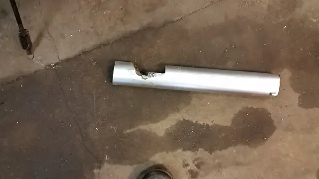

Here's the bad section of frame that motivated me to do this in the first place...
And here's a trial fit of what the new tube will look like, I tried it with the bend closer to the bottom but liked the way it looks with the bend higher up, and this way offers the most room for the engine when I'm ready to put it back in... I'm gonna have LOTS of welding to do first tho...

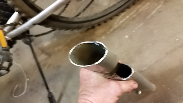

Oops... almost forgot this one... This is just to show just how thin the wall thickness of these cheap Roadmaster Mountainbike frames really are... No wonder I blew a hole in the metal when trying to weld up the crack... and I had my amps and speed set really low too... I didn't measure the wall thickness, but if my eye calibration is still good enough, I'd say it's about .040" thick at best... I'll measure it tomorrow just to see if my eye calibration is as good as it used to be. The new tube has a .080" wall thickness so if anything breaks again, it won't be the bottom tube...

Yer right Davezilla,after building about 10 or 12 of the OCC chopper bikes, I decided the frame is way too thin to build a really safe MB and wont build on them again. NOW, The Jesse James chopper, By Huffy, Has a heavier frame and makes a real nice build. although I've only done one of those.

I kinda figured that when I got that tube cut off the mountainbike and saw it was exactly the same as the OCC Stingray's bottom tube... I do see some doublers and gussets in that bike's near future before it's put on the road...
