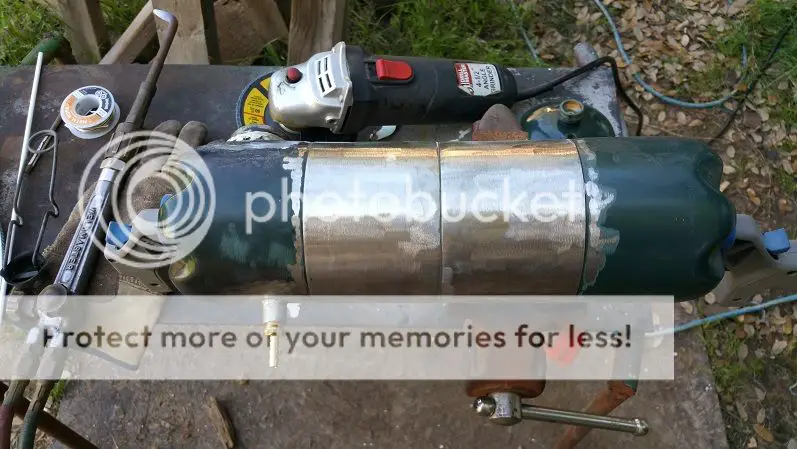

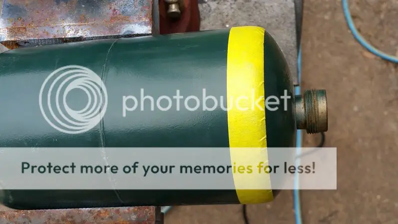

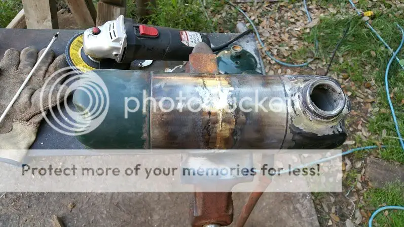

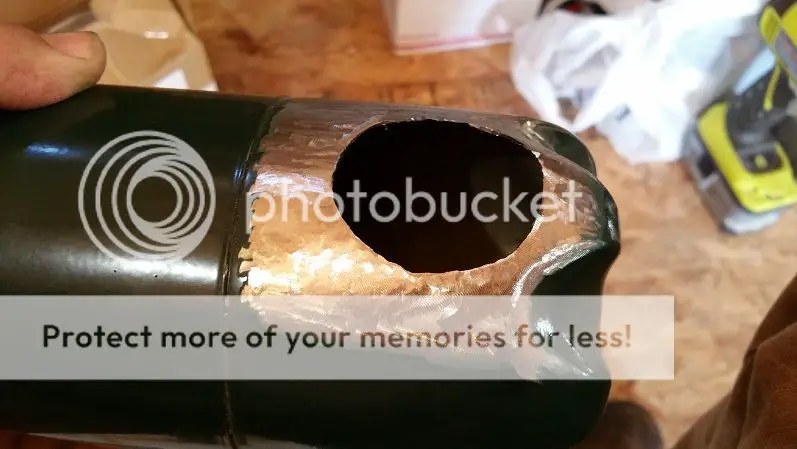

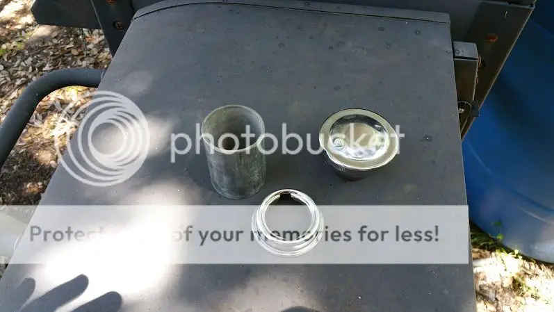

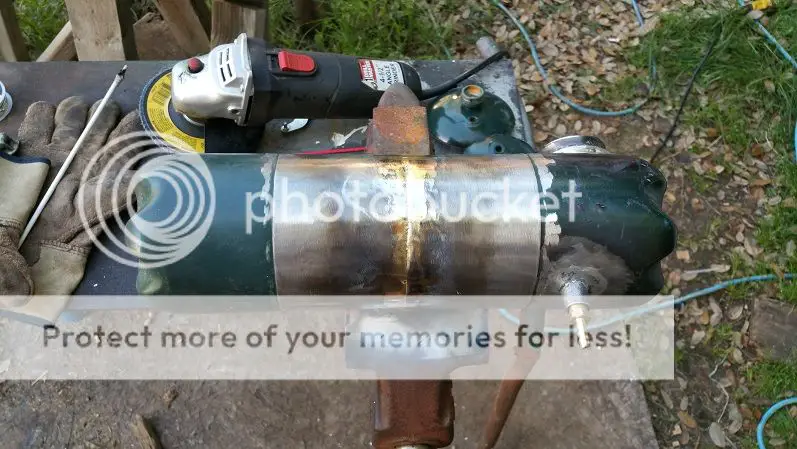

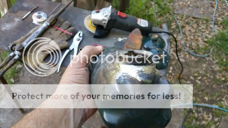

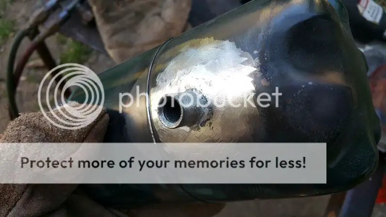

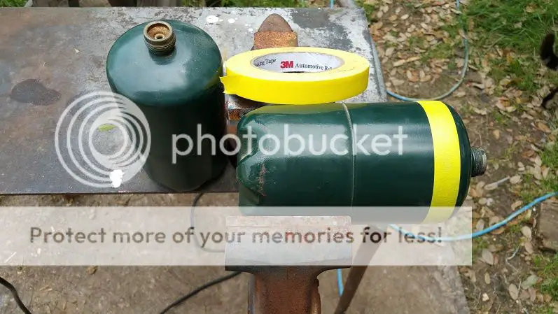

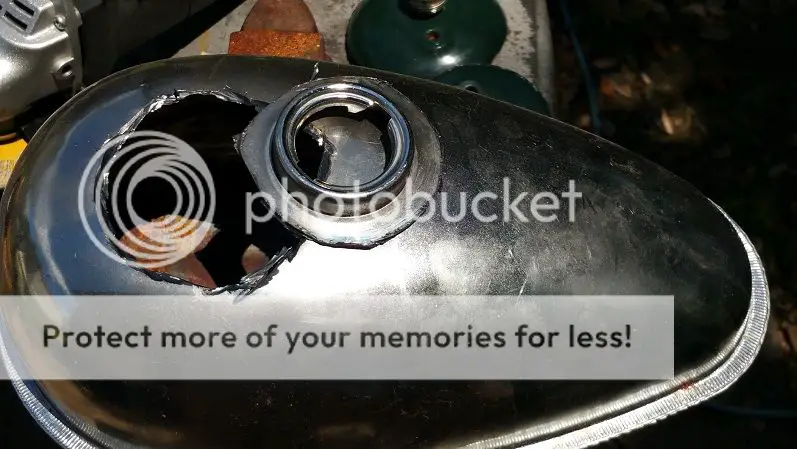

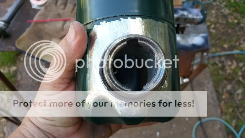

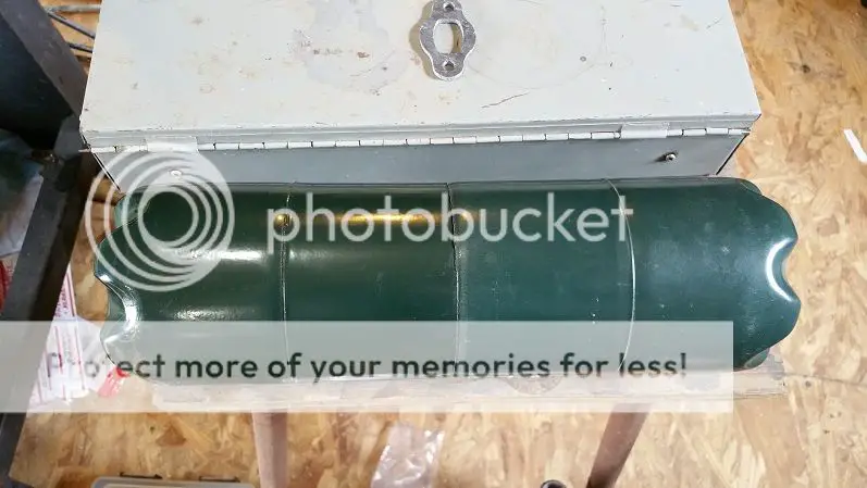

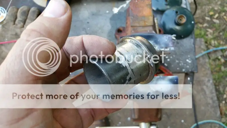

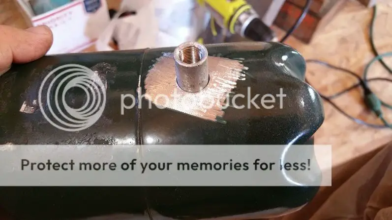

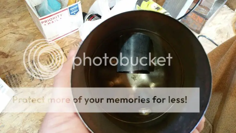

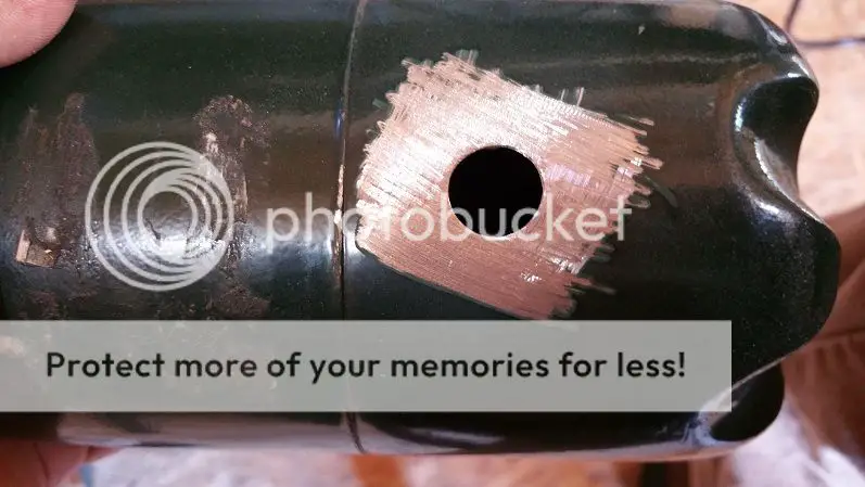

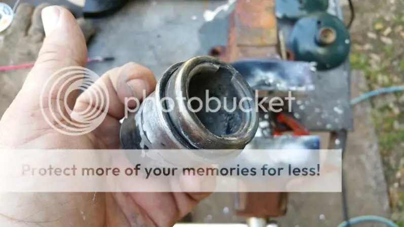

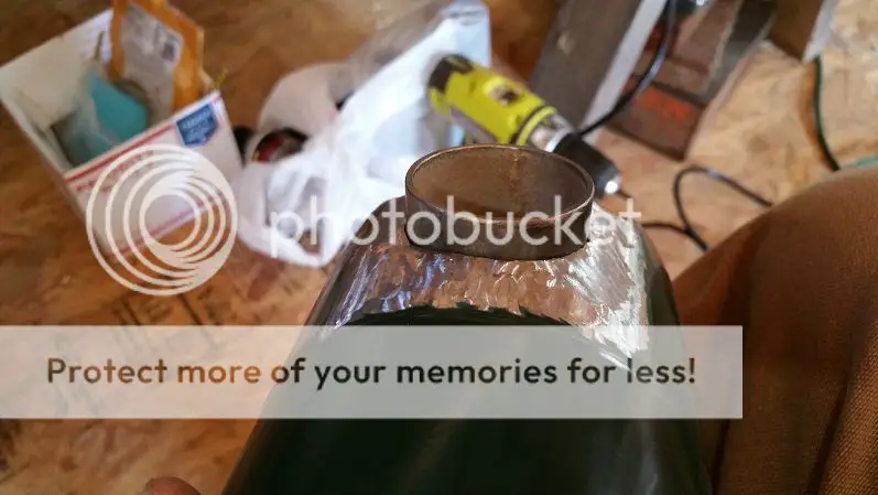

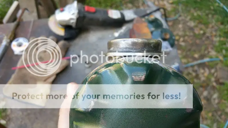

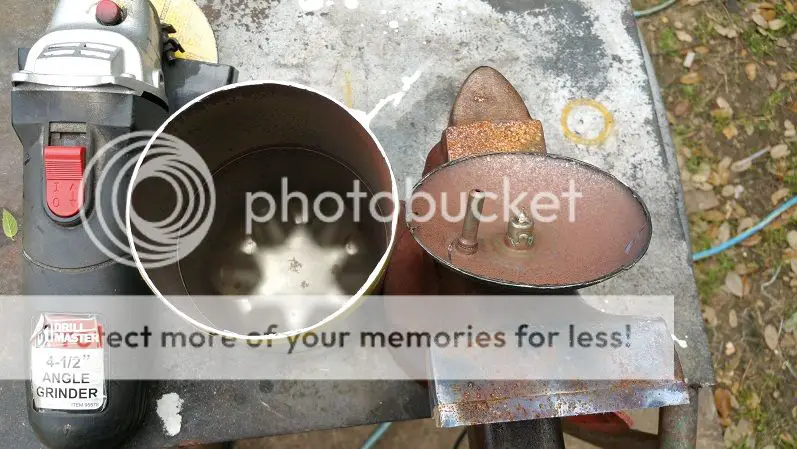

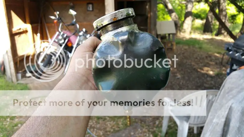

built me a fuel tank for my Yellow Taffy build, when you see what I built it out of some will shreak a bit pobably, but the tanks were well purged before any cutting was done on them, actually pulled the valves out of them last year and then today I pressured them up multiple times with compressed air and held them so the exit was at the bottom so if there was any gas lingering it would be blown out since propane is heavier than air.
CAUTION.... IF YOU DONT KNOW WHAT YOU'RE DOING, DO NOT CUT, PUNCH HOLES IN OR GRIND ON PROPANE CYLINDERS, IF DONE WRONG YOU MAY GET A BIG BANG OUT OF IT.....!!!
I will be posting several pix to show most of what I did from start to brazed up and ready for a good coat of truck bed liner.
wasn't sure where to put this, but this is what I did today so I thought I'd just post all of it here.
Well, I have it a little farther along than this now but this is all the pix for now, hopefully the coating I put on it will turn out, I didn't like the way it sprayed on, but if I dont like it I'll just wrap the tank, but this is my project for the day.

I did all of this with a acetylene and oxygen torch & fluxed brass rod, I do have a mig welder and a couple cracker box stick welders, but for things like this I like a torch and either brass rod or a cleaned up piece of just mild steel wire like a coat hanger, I'm no pro at it but I can make it work.

I sure do like the looks of that tank, even uncompleted. I've long had the urge to sit down & explain to whoever designed the 'kit' tanks just why it was wrong to put the opening for the valve on the right-hand side of the tank.

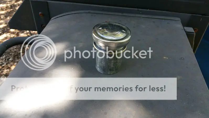

Another thing that works good for tanks like mapbike's,is track light canisters. Nice round dome end and different sizes. just make sure they are steel not aluminum. I got mine at habitat store $2 each. If you stick a piece of brass ,copper ,or aluminum behind the holes you can weld them shut the weld wont sick to it................Curt
That's a great idea for making a tank and nice job on cutting up a few of the propane bottles to give it the capacity you're looking for... Personally I would just grind or power sand all the paint off and then clear coat it to show the braze joints, but either way it'll work great and look just as good... I'll most likely fab my own tank for the Stingray once I get it that far along but I'm not even gonna start on it until the bike is at least at the roller stage of the build. I'm just in the process of de rusting a lot of parts, buying parts that were either missing or rusted beyond help etc right now....
