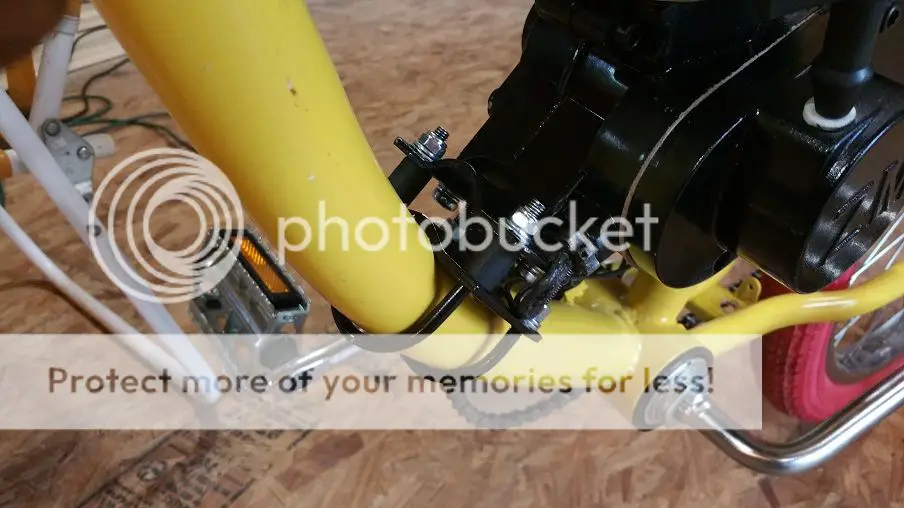

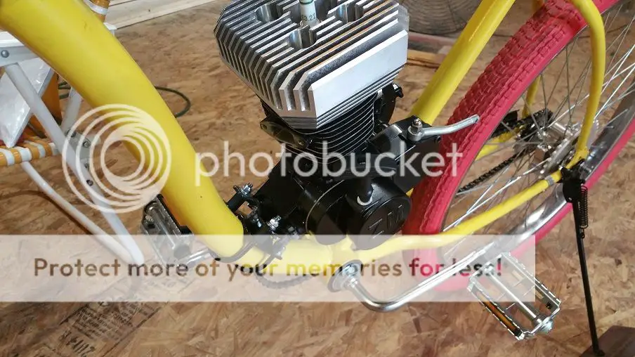

Actually did several things to the "Taffy Bike" today, finally got the front mount made from old kit parts I had laying around fixed the way I wanted it and got the engine mounted solid to the bike as it will stay now if all goes according to plan.
The two pix below show it at its "finished" state, I could have made a much simpler front mount or ground the paint off the frame and made a weld on frame engine mounting tab, but I had these parts and I knew they would do just fine for what I needed, so instead of them going to waist I decided to use parts of two different "big frame" kit mounting set ups to make the one mount I needed, It's not real clean and fancy looking but it's rock solid so I'm good with it.
Also I have included a link after the pix to where I posted some info pix of the exhaust flange I built today for the Taffy bike from a grade-8 7/8" ID flat washer and a piece of a front fork I cut off of a just set of forks I had.

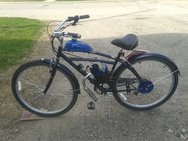

its a Schwinn midway 29" steel frame and rims its a newer model motor kit the front mount is a 1 1/2" comes with the nt speed carb and has a really nice cylinder most of the mold lips and other b.s. in the ports are really clean better than most of the ones ive been getting
Dang-it thats right, I remember you saying something about that Schwinn 29er.
I'd like to have on of those frames and I'd put eitheer a 24" or a 26" rear wheel and then 26" with a suspension fork on front for a lower stretched out look.
I like that bike, I bet the standard 44T sprocket gears that 29" wheel similar to what a 26" wheel would be with maybe a 38T.
How is the overall balance of those engines?
should be but id rather put a 36 on this one I bought the hub adapter from kings and it wasn't the right size silly me didn't read the caliper right thought it was 1.50 but it was 1.25 guess I have two of these hub adapters that ill never use oh well live and learn..................how to read LOL
i need to figure out a spacer to turn these 1.50 down to 1.25 then i would be able to use these on the Schwinn midways
The 1.5 hub adapters are for many of the coaster brake hubs like the Shimano CB-E110, Huffy Falcon, K-Stop and a few others, I know you don't use coaster hubs though.
A split bushing could be made and then they could be used on the 1.250 hub size wheels.
If you could find some aluminum tubing with a 1.250 ID and the right wall thickness you could cut a piece, split it and you'd have your bushings to adapter those for the 1.250 hubs.
