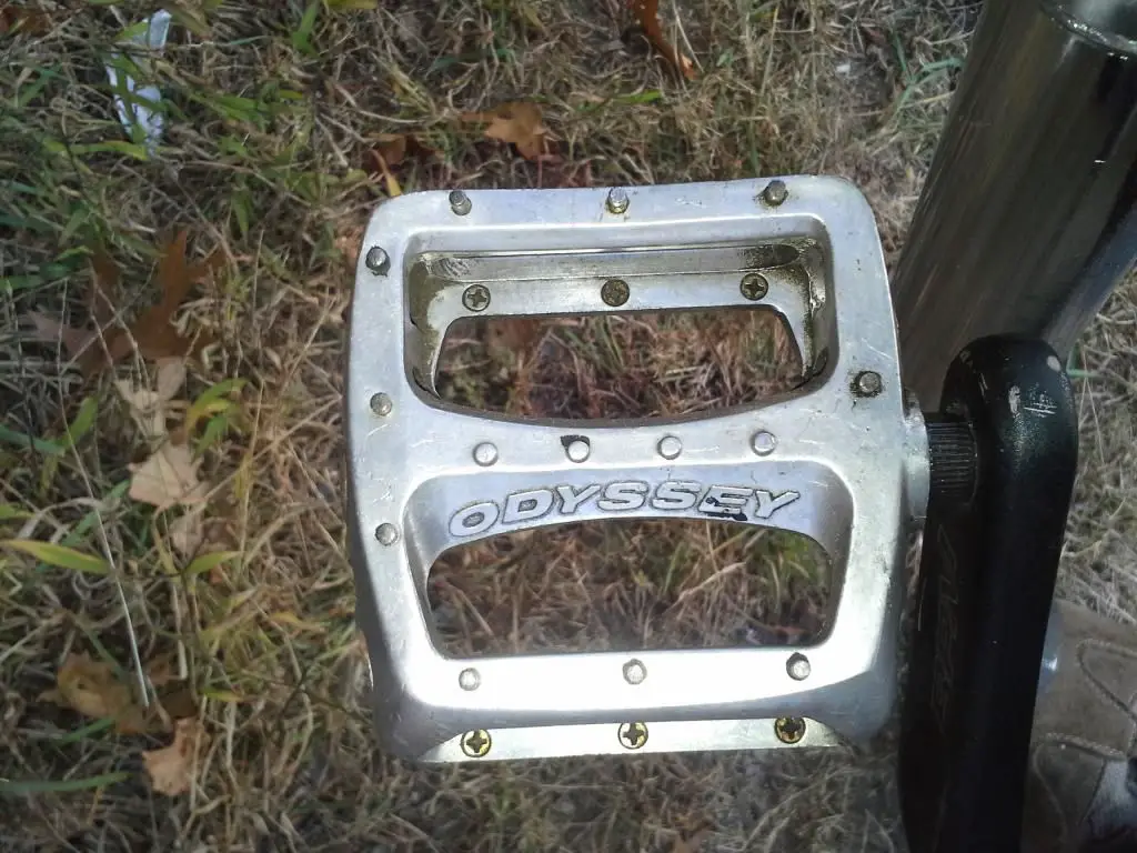

I had a bike similar to this one mine was a crane brook huffy the first time I stood on the pedal to take off the plastic pedal snapped off and almost hurt me something bad I replaced them out with these and after 4 years of hard daily ,year round riding, This set of pedals is all I have left of that bike!! Yours looks much better than mine did + I was weighing in @ 305lbs at the time
