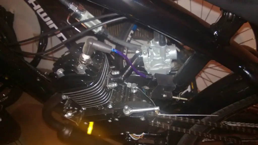

Well, the exhaust isn't quite complete --- yet. Gonna have to get a new exhaust gasket (3 or 4 probably), and a clamp to replace the wire support at the rear. I did MAPP gas the welds -- ran it about 30 minutes and all seems OK, so far. It was quite a bit louder than I was expecting, so I'll try some steel wool in the muffler.
Maybe because it's now louder, but the motor seems to have 'woken up'! It pulls harder on acceleration and feels more 'comfortable' at cruising speeds. I guess that time will tell how it'll hold up. For now, though, I'm satisfied with the results.

Looks good, looks good. I'd watch the exhaust on the rack though, plastic + hot exhaust = melted rack. lol
I'd love to do something like that for my exhaust, but I don't wanna cut up my existing pipe. lol
You got a pocket bike muffler on it? I bet it sounds bossly.

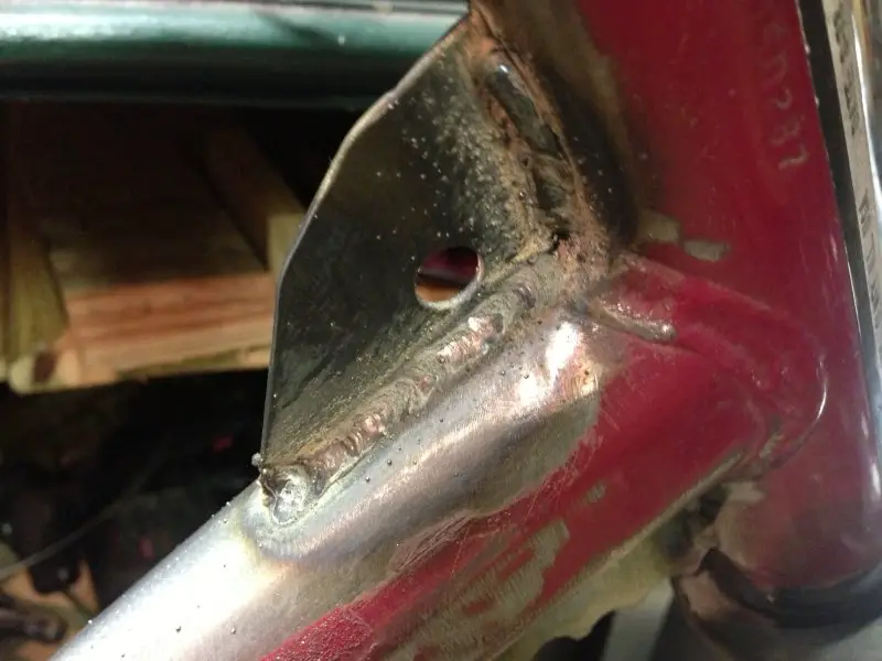

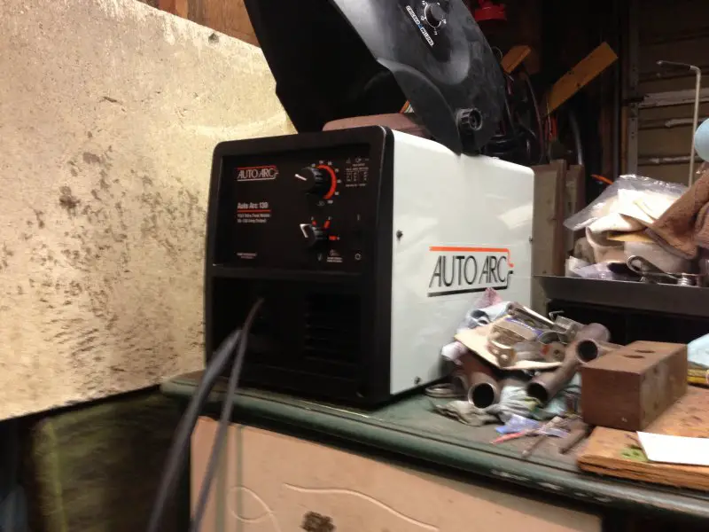

Got a new welder and it welds so much better than my other welder.
Still not a MIG quality looking weld, but is 150% better.

Dracothered, You have got me thinking I am going to at least try the flux core on that same welder I have. Never did any flux core, always AR/75 CO2/25. Those pics are they after just using a wire wheel as you got the nice weld puddle ridges showing that welds ought to have!
What size was the flux core and did you go exact by the chart on the inside cover for settings?
MT
PS A flap disk can get rid of the weld spatter and still leave most of the nice weld flow shape intact, so no biggie there.

Went .030 and yes I used the setting they listed. Just wire brushed it off for that picture.
