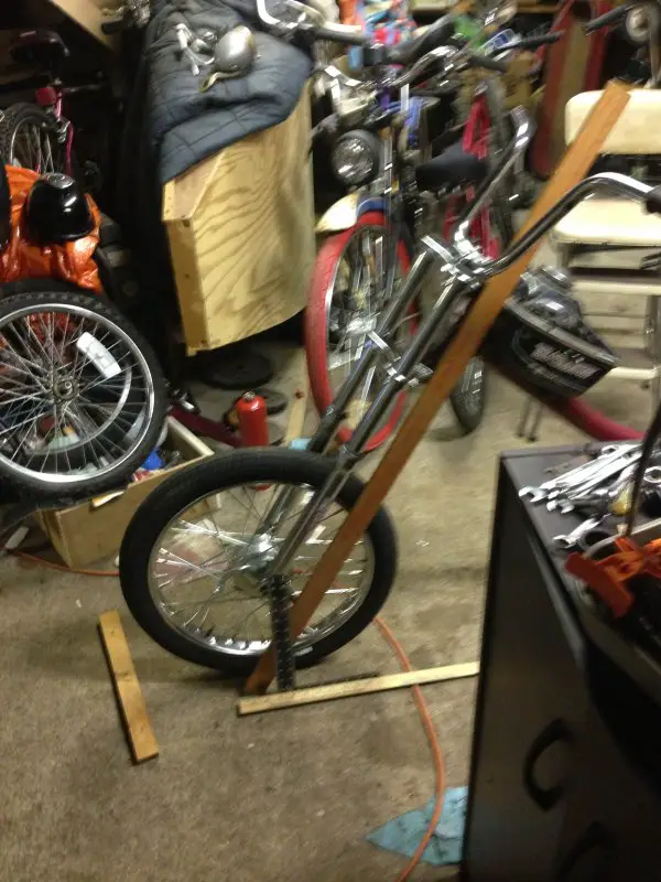

I checked my front end geometry today on the AMF build and it looks to be good I think.

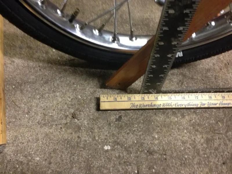

It looks to be about 3" of trail which if I remember right is in the good range.
