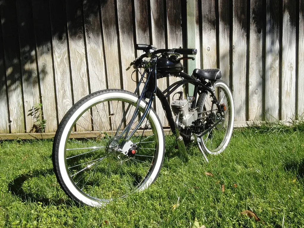

Installed an Avid BB5 front disc brake kit. Best upgrade so far besides the motor lol. Homemade prototype bracket painted and installed...
