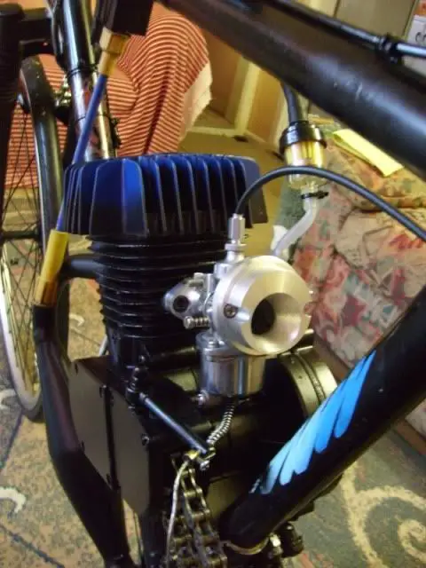

I added a billet velocity stack from JNMotors to a modded speed carb. The standard air filter restricted it to the point it would hardly start I thought it had a fuel bock hence new filter and line. Once an aftermarket filter was fitted that made all the difference, I think the stack was hard up against the back of the standard filter when it was tightened. It did seem to give it better acceleration after some reaming of the stack to get it closer to the intake of the port of the carb.
