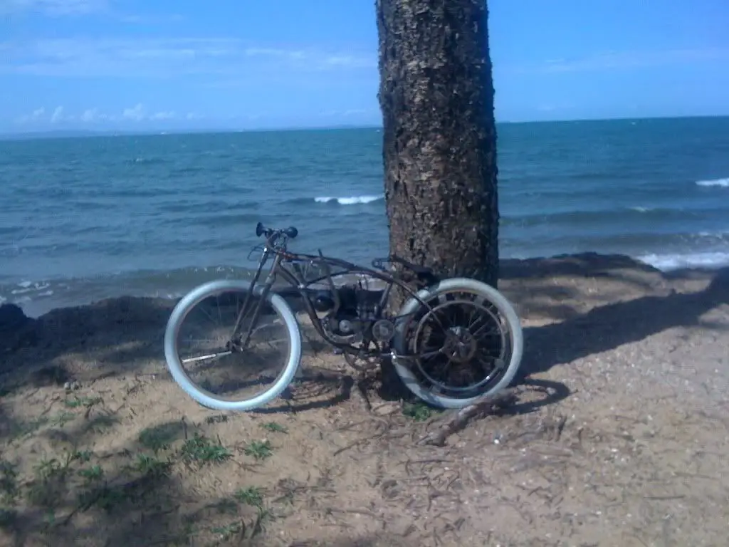

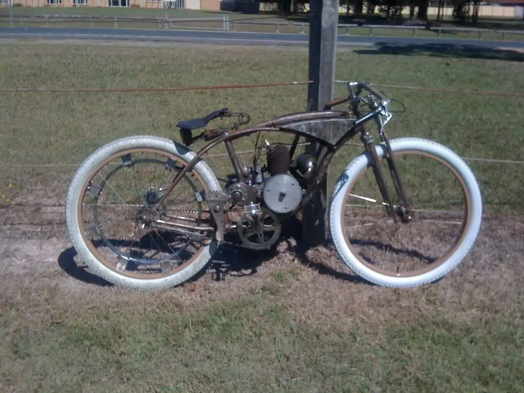

You get a good look at the clutch in his 3rd picture....Do you think its the original clutch? It doesnt look like the clutch i got with my reel mower. I think i may pull apart my mower and have a better look at my clutch, or maybe take pics and see if any of you more mechanically minded guys might have more of an idea..... i did actually wonder whether the mower clutch could be used but i figured it wouldnt be strong enough.

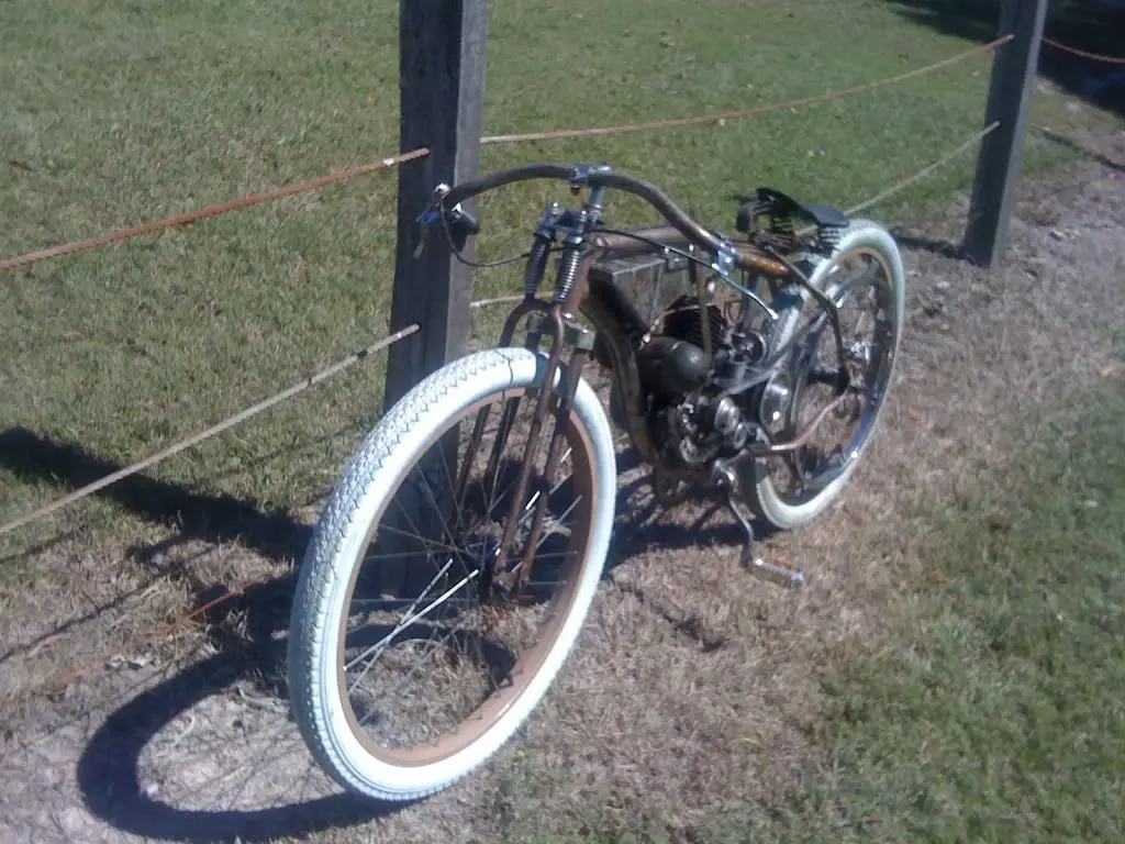

I just had another look, and its actually the 4th picture that you get a good look, im thinking it is a centrifugal clutch because i cant see a clutch cable or clutch lever????

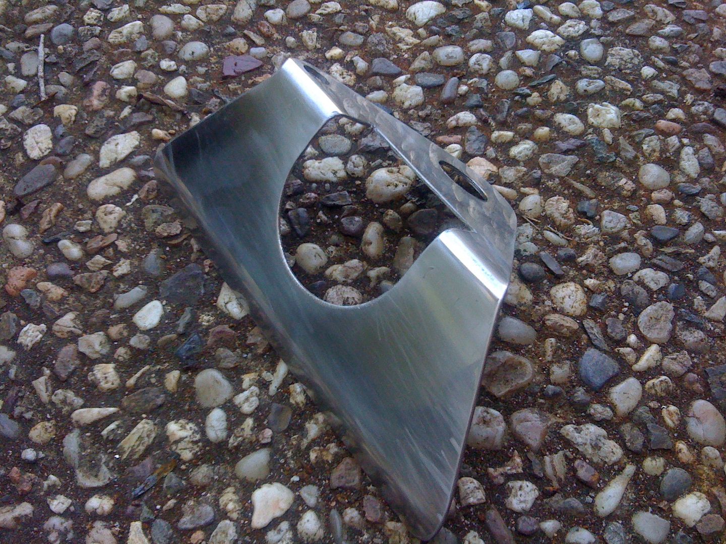

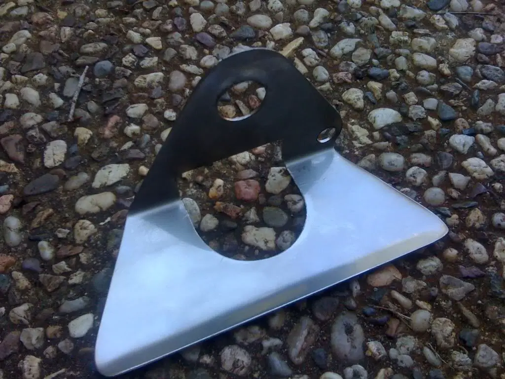

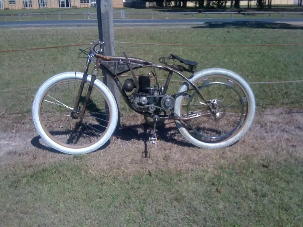

Id been having problems with the primary belt not slipping when i wanted it to, i.e i couldnt pedal it without engaging the engine. And because of this i couldnt start the bike (i havent fixed the kickstarter to work yet... the teeth need tidying up). So i made a guide out of stainless, i figured this would be less abrasive against the belt then steel. It was a little tricky as i had to miss the carb.
Anyway i got it done and it works perfectly, now when the clutch is out it pedals like a bicycle again
harry76
Apr 16, 2011
2,557
47
48
Brisbane, Australia
So now thats fixed i took it for a ride. YEEEEEEEE HAHHHHHHHH. Its not a rocketship, but more then fast enough and i couldnt get the smile off my face the entire ride. And some of the looks from people was priceless. The clutch worked fine and im guessing i got it up to around 60kmh. Very very cool. I have a few little issues, my fuel tap is leaking and also my exhaust, but i still havent sealed the exhaust as i planned to have it out again. Now i can fix it and do a couple other things. But i am wrapped with the first real ride. Im going to get a new plug, this is the one that i got with it.... looks very old.... gotta love these engines..... still going.... how many chinagirls will still be running in 70 years????

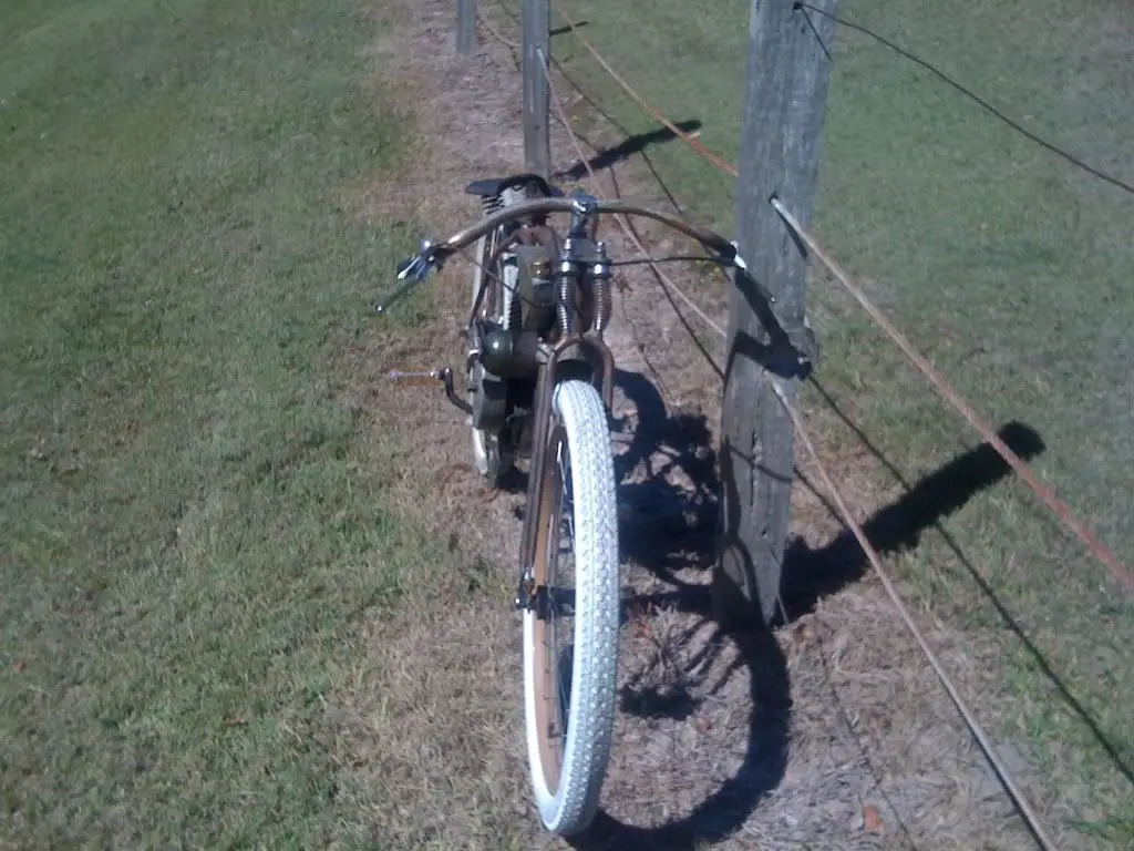

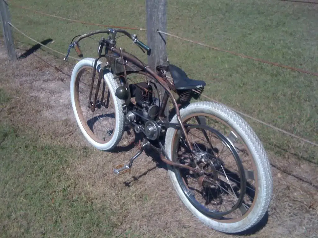

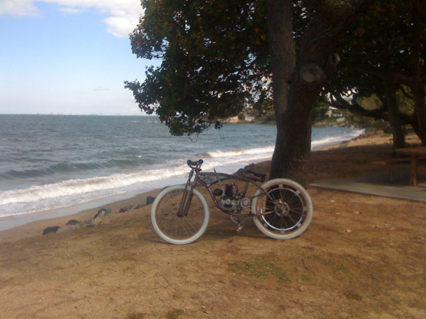

Thanks guys.... im very happy with the bike..... and today i rode the wheels off it. I rode it for around 5 hours and it never missed a beat, i do think i need to buy a plug for it though. It has its moments where for some unknown reason it seems to have more power and i can get up to 60kmh (speed limit) but most times it lags a bit and runs around 50kmh. Its slower off the line then a 50cc Chinagirl and will take off without pedalling but its slow and needs s couple pedals thrown in..... but once it gets going its soooooooooooo cool, sounds way better then a chinagirl and vibrates way less and you get the feeling it could do it all day everyday whereas i was almost waiting for my chinagirl to detonate half the time i ride it.
My only real problem is with my fuel tank, its leaking from the thread where the petcock meets the tank, i think the steel i used wasnt thick enough for the thread i tapped.... i have temporarily fixed it with good old soap.... but im wondering how i can fix that? Is there a fuel resitant loctite or sealant i can use? Is plumbers thread tape fuel resistant? Or is there some available? Any ideas?
Some pics while out on my ride today..... im itching to ride it more but its dark. Im running my bike without its stand as i need a better way to secure it while riding.....
