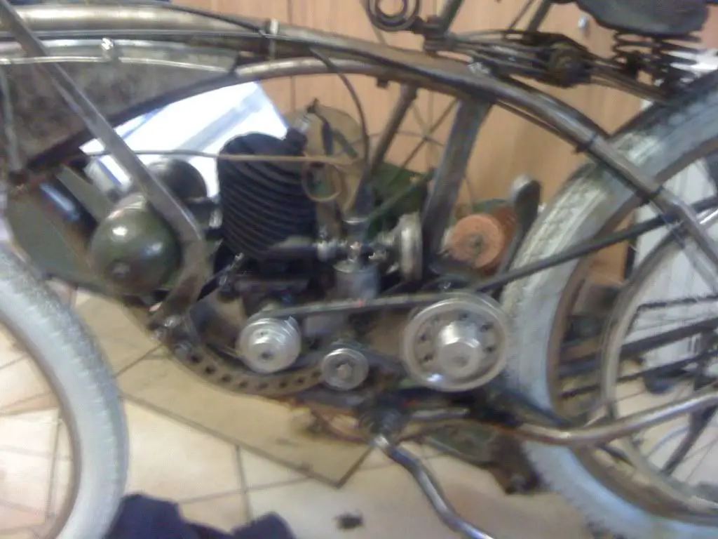

yep ! as i said from my tests 1/4 h/p so needs to be low geared to get going slugg of the mark but will wind out eventualy to a breathtaking speed of anywere between 25 and 50 mph depending on condition of motor uphill -downhill ,headwind - tailwind but its all fun !
Cool, thanks..... id be happy with those speeds.......Wilrod, i dont suppose you know the top rpm of these engines?
carnt help there harry as i don't have a mechanical tacho ,(note to self must get mechanical tacho , toolbox must be incomplete ) just got back home from a ride and was passing traffic most of the way must hook up the speedoauflgauflgxct2

my bet is on 30-40kph depending on terrain for a decent start and free running engine at cruise.
I also feel a gearbox would use up considerable power which is in short supply from the gate.
Someone mentioned the circumstance with the engine design and the piston/intake port not allowing much improvement to create more HP. Probably true! Somewhere near 12:1 overall, depending on terrain will most likely be the most serviceable. IMO...

ok so i have spent the last hour and a half hooking up and calabrating the speedo took it out for a quick spin around the town on the flat slight cross wind full throtel 49 kph kenauflg
49kmh is enough to put a smile on my dial, but will it be enough to keep up with my girlfriend? LOL. I may have to weigh her bike down :-)

Well i got my pulleys back from the machinist, i gave the machinist a 2" pulley and a 3" pulley to put a thread on. And just my luck he stuffed the backspacing on the 3". He did say hed try and fix it if i left the motor and pulley with him. I said i needed the motor but may return it later for him to fix. Although after what Wilrod said i may not need the 3" pulley, that 2" front pulley should be about right.

I have the 2" front pulley fitted and tried to ride it but it now deinitely needs that upper primary guard/guide to allow the primary to slip when needed, as i couldnt even pedal the bike. I cut some stainless steel at work and just need to modify it to fit.... ive just started a 5 day break from work so hope to get all this done.

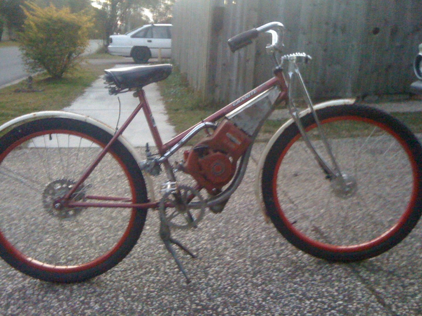

Heres where im at on Kellys bike and pretty much where it was up to before Greazefest
