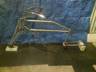

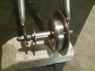

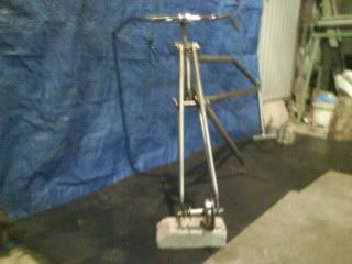

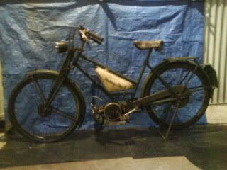

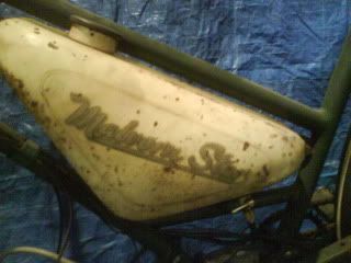

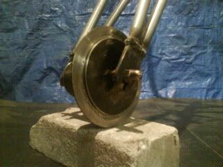

ok if this works there should be the 42 malvern star and some pics of the frame and font springer forks and the drum brake front hub that i am makeing at the moment kenauflg
Man that is cool, i wanna visit your shed.
Did Malvern Star make a motorized bike? Is that a Villiers?
Nice hub, did u make it? You the man!!!!!!!!!!!!!!!!!!!!!!!!
Where do you find these things? Awesome awesome awesome!!!!!!!!
malvern star is a 1942 malvern star autocycle and yes its a villiers 98 cc junoir deluxe motor the same as in my excelsior and also in my yet to be finnished francis barnet powerbike . The project bike frame, forks and front hub are all my own work i plan on making most of this my self to my own taste but old worldly enough so as to have the re-storers (read "paint it black and put it back) scratching thier heads and flicking through thier id books . ken

the villiers junior deluxe 98cc was built for use by autocycle maufactures during the 40's and early 50's they have an inbuilt wet clutch but are only single speed , in 1947 excelsior started making its own autobyk motors the goblin and the sprint known as a G1 or a S2 the 2 denotes it is a 2 speed gearbox/motor combo BUT trying to find one of these sprint 2 speed jobs is almost imposable here in aust . In my project bike i am going to use an atco villiers with the slooping head fins but leaning over so the fins are level run a primary belt to a gearbox from an unknown early british m/cycle has hand shifter then belt to rear wheel ,belt tensioner type hand clutch, pedal powered to start or use the kick starter on g/box when on its stand . ken
