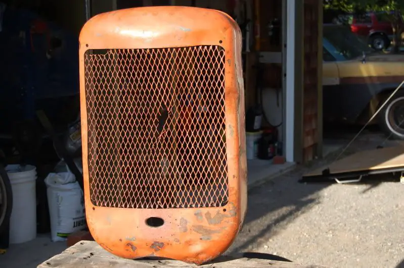

I'm thinking that the front of the canoe body will need to get narrowed up some. Steve is planning to use an Allis Chalmers Model B tractor radiator cowling for his front end. A good choice, I think. Don't know what I'll use. If an Allis like his, then I would need to section it so that it is less tall. And to think I gave away an Allis B with a frozen engine years ago. Maybe Steve will post a photo of his Allis cowling so you know what we're talking about.

If I were to use one like that for mine I think I'd need to section it so that the grill part was roughly square and not so tall. The cowling would still come down below the body of the canoe. I like the idea of housing the gas tank right there inside the cowling and having the filler cap come out where there would have been a radiator cap. That's a good looking grill. I'm picturing the axle right in front of the grill.

I just did some measuring. I was curious about what we did with the sidecar portion of the donor canoe and we narrowed it to 20" at the stern. It is 12" deep from gunnel to floor For perspective the sidecar is 5 1/2" long. Photos of the sidecar body are below. The velocar section would be 8 1/2' (or shorter) and then add four to six inches for the radiator cowling. The windshield measures 20" wide. The axle is 48" long.
I'm not clear on how we'd do it, but the wide end of the donor section is now 36" and it would seem to me that it would need to be drawn in to about 24" in the area of the cockpit where the driver is seated. So from the narrow end it would taper to 24" (or thereabouts... no less than 22")and then if it could again taper from the cockpit to the radiator cowling to 18" then the Allis front end would work.

The grill was a surprisingly cheap. $21.50 and he parts out tractors in Iowa on a regular basis. The shipping and handling to get it here however was $50. Still a bargain in my books.
It was on ebay under tractor grills. The more popular ones bring some pretty fancy money. Mention John Deere and strap you and your wallet in before the rocket takes off.
The guy I bought it from is called Daveysalvage.
I think that 24" is the best width for the frame. We can cut the keel out of it as far back as the rear cockpit and trim the bottom of the canoe so we can pull it into shape. It will need a wood frame to set the body on so once that is done we will be able to shape the body to fit.

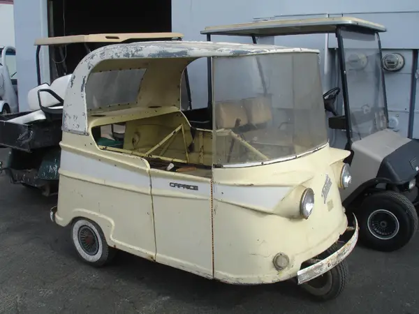

http://www.golfcarts2go.com/images/caprice-golf-cart.png
None of these are really new, but I like them. I think it puts you on the bottom of the automotive status symbol dogpile though, to have less than 80mph top speed, less than 200hp, or less than 4 wheels. Unless you have a vw based chopper trike. ;-) Still, drive what you like, and stinks for the cagers.

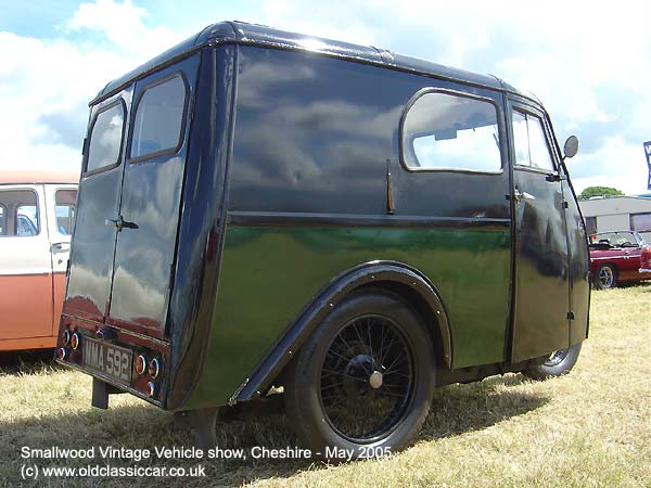

http://www.oldclassiccar.co.uk/photos-smallwood/2.jpg
Single front wheel trike with closed in canopy, sliding doors, spoked wheels, aero windows.

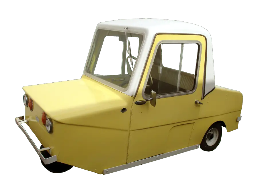

http://farm5.staticflickr.com/4044/4337907537_d6a651e687.jpg
3 wheel mini utility truck
This looks like what I'd shoot for if going for the most pared down design, starting with an existing bike.
