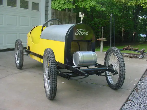

Those cyclekart sites were where I got some of my inspiration for my upcoming project. However, if my classic-styled tri-car is going to take to the streets, it'll need to be a wee bit more beefier than these lightweight karts, as well as having a full complement of lights and such.
