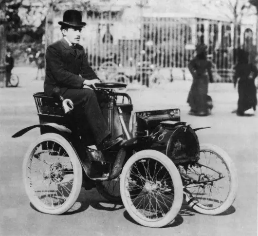

De Dion built great engines for the time period. Do you know the year for that Renault? It looks interesting. At 273cc, even with the lower compression of the time period, given that De Dions tended to rev higher than most I would bet that little lightweight-looking Renault probably moved rather quickly. Especially with the ability to change gearing.
