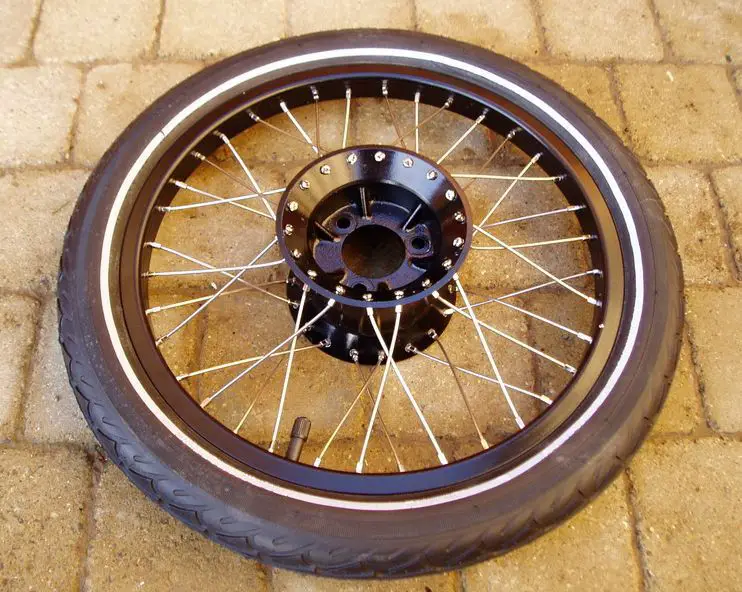

Work is proceeding on this project. Just by looking at the heap of bits on my workbench I know something is happening even though at times it's hard to tell what it is. Having had some days of not being very well hasn't helped any as now I'm having to sort through all the miscellaneous parts of several dismantled ATV axles as well as a Peerless diff in an attempt to pick up my train of thought.
Finding myself short of various small parts has led me to the decision to buy a new 50cc Chinese Quad bike which I shall break down for its components in an effort to finally end up with a workable drive train. A local trader has a bunch of the things at half price and is offering layby over two months so I'm going for it.
One of the things I want to do is adapt a spoked wheel to fit on an ATV axle and the method I will be using is one I stole from the cyclekart guys. After a lot of messing around trying to find individual parts it's going to be sooooo much easier and cheaper to just buy the whole lump and be done with it.
