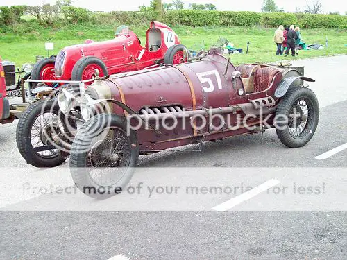

Building the Colombe is going to be a dry run for when I build my official by the rules cyclekart which is going to be based on an Amilcar-Riley special from the 1920s. Wood is very much going to feature in most of the structure with the Colombe and I'd like to do the same with the Amilcar as well. If the Colombe doesn't fall apart then hopefully everything should be fine when it comes to the Amilcar.
The prototype: 1925 Amilcar-Riley Special.

I like the Amilcar quite a lot, from those great headlights right on back to the other end. Very pleasing to the eye.
