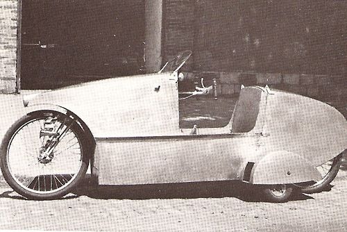

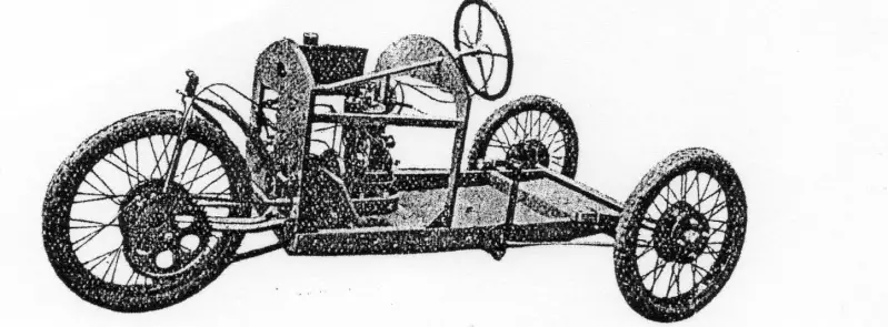

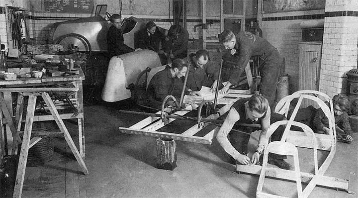

This is a classic photo of chaps building velocars back in the heroic pioneering days of such things. Some of you will have seen it before, but I'm posting it here because it's so much like the sort of thing I'm going to be doing myself over the course of the next month and a half.

maniac57,- I absolutely love these old photos. They represent a time when the most amazing vehicles were made in small workshops from ordinary materials with ordinary hand tools; - and then as you say driven at breakneck speeds.
I want; - I very much want. And my new year's resolution is to build wonderful vehicles using just the same methods and materials as they did back then. Hi-tech who needs it.
My idea of a proper velocar, - the young lady in the driver's seat is almost wearing the right sort of hat too.
