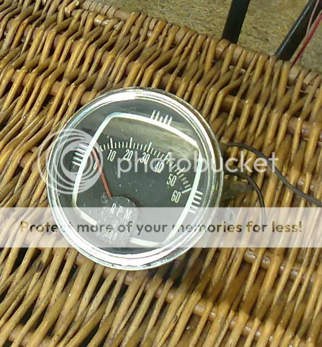

On a whim I went into the local junk shop today and I'm glad I did because I was able to get this for just $NZ5.00........
I have no idea if it works and I can't find a makers name on it, but I do know that it's going to have a place to call its own on my Intrepide cyclecar's dashboard.

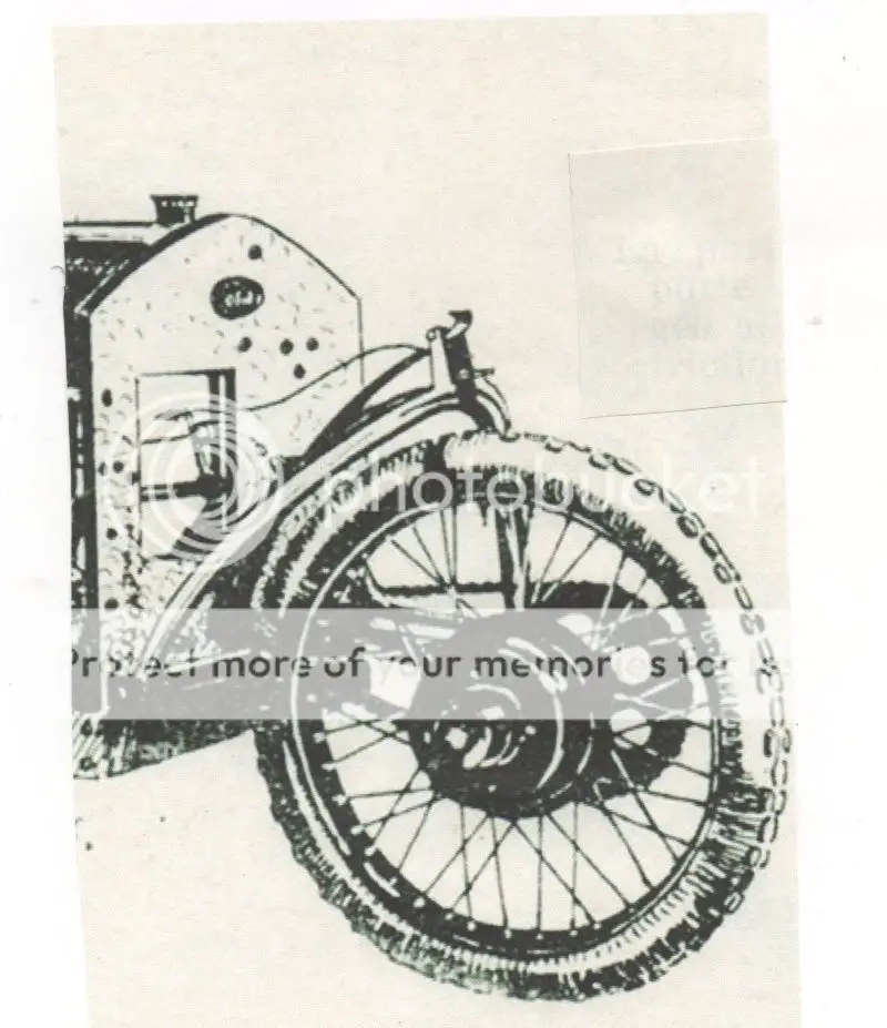

Being a member of a French cyclecar forum has paid off already because one of the forum members sent me a diagram that shows what the right hand side of a Colombe cyclecar's front suspension looks like. Any useful picture of a Colombe taken from the right hand side is rare so I'm absolutely delighted. With a large piece of the puzzle having dropped into place I now feel a lot more confident about this semi-replica I'm building.

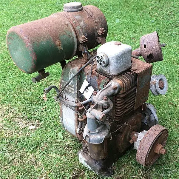

I nearly crippled the local courier driver this morning when he delivered the OHV Mk 15 Villiers engine I'd purchased. That's cast iron for you, it likes to stay put and not be moved around. ;)
The cylinder bore looks great and the engine turns over nicely, but the cylinder head is trashed. The side of the exhaust port is burned through and the exhaust valve seat is beyond all hope, but I knew that when I purchased the engine for the princely sum of $NZ8.00.
The cooling fins on the exhaust side of the cast iron head are woefully inadequate and I'd say that this engine would have been running with a big glowing cherry red spot on the side of the exhaust port before it finally burnt through and brought play to a close.
I was going to use my pre-war Villiers two stroke engine to power my cyclecar, but this four stroke Mk15 engine will be taking its place instead. I have other plans for the pre-war engine where it will be more out in the open air so its pretty shape can be admired.
