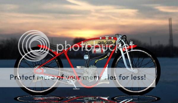

    I can't even afford to buy smokes , so all i can do is make quik little sketches of what i wanna build . I got 4 cents for the person that can tell me whats wrong on the bike .

    Too easy.....fuel filter is installed in wrong direction and the safety clip is missing on masterlink! You owe me 4cents.

    The engine is wrong.
    The magneto / drive sprocket is on the wrong side.

    Likes Received:
    fuel filter is hollow , dosn,t matter what way its on .
    i never use master links

    Yeah, the engine's a mirror image.

    Nice sketch!! Looks killer! All right here is my guess to difficult to R&R the rear wheel. Do I get 4 pennies?

    Ya got an oil tank with a HT engine. Nice drawing!

    Fuel filters have arrows showing flow direction. The outer portion of them acts as a sediment bowl.if reversed, all the trash/sediment esaily clogs them and you can't see when they need changing.

    5-7 : Yeah theres money in drawing things up , but where do i find a job drawing up the things i wanna draw .
    Allanwrench : I just have to wait till i get a job to build it ... broke ain't even the word .
    Goat : Back wheel is done like a motorcycle , i,m going to modify the hubs from my sachs moped ... they are 36 spoke hubs / with drum brakes .
    Already did the rear hub . haven,t started the front one yet .. i will do the same .
    ( knocked out the bearing cups , welded a spacer inside the tube/bore ..whatever , 30mm OD goes in snuggly , replaced the crappy cup and cone bicycle bearings with 30mm x 17 mm sealed roller bearings )
    Now i just need to make the shaft and bearing spacer for the shaft ... hard to do , i don,t work in a machine shop any more .. i don,t even have a job to pay someone to make me one .
    THEN ..just lace up the hubs to some 26 inch rims ... there gonna be sweet )
    Wayne : Thats not an oil tank , its a boost bottle , I want to make it out of a couple tomato juice cans soldered together . the ridges on the cans make it look old shcool , real old .

    Looks good, If I was pressed to find something wrong I'd point out that based on scale your bike has a stand over height of roughly 48" and running 36" tires. Lets just say its Shaquille O'neal's latest project. But art is subjective and is judged by how it makes you feel, And this one makes me feel pretty good! hope to see more sketches soon.
