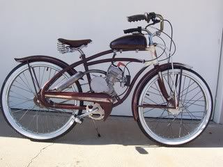

Well guys... My frame is at my workplace waitin' ona tank, rims are all painted and at the local bike shop waitin' to get laced...
Which leaves me not much bike left over to work on. I suppose I'll follow silverbear's lead and start tap-tap-tapin' me some fenders lol I did manage to pick up a coupla cans of my spiffy paint so if I can manage to get those ol' chunks of steel to be vaguely presentable I can give 'em a squirt and show ya'll the color.
I meant to take some pics of the rims all painted but to give ya an idea how hurried I was to get them to the shop (they're closed tomorrow), I hadta put 'em in plastic for the trip else they'd stick together lol The paint will prolly be damaged because of this but I don't mind a lil touch-up.
It's unlikely the pics will show the color well anyway, it's a slate gray (very mild metalflake) so dark it looks black unless it's in direct sunlight (or contrasted with actual black). I know the detailing and original pattern done in semigloss black on such a dark gray wont show very well... but I like that about it lol I had an old (not vintage - just old heh) Chevy Malibu that was gloss black with flat black stripes - everyone thought it was odd, but I loved the thing ;)
It's kinda weird... I didn't really pick the gray, it was something I just happened to have a can of and I know it's a really tough paint so I decided to roll w/it. The more I think about it though - the more I'm diggin' it :D

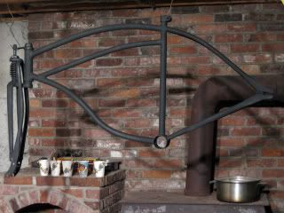

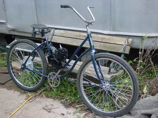

I have posted some photos from today's work. The first shows the headlight adapted from an Eveready dry cell type lantern. I removed the headlight portion, drilled a hole in the back of the inside light casing and then widened the hole with a cone shaped grinder attached to the drill. Into the new widened opening I placed 18 6v LED lights purchased in one strand as battery operated Christmas lights in a warm white. I found these at Target for $6.00 + .The strand comes with a little battery case for 4 AA batteries and has a switch. The lights were left connected to each other and the wired bundle taped so that the bulbs are all together, pushed into the opening facing toward the lens. I've done this on other old headlights and run them off of the magneto. Works fine for me and the price is right. All together I have $11.00 invested in the headlight. I used mounting hardware from a dead bicycle light from my department of dead parts.
Second photo shows the 'new' rear rack which was adapted from a 1960's Schwinn front rack. With a dremel cutoff wheel I removed the spring loaded clamping mechanism and then did some bending of the lower arms, drilled out the holes so they could attach at the axle and then did some creative pounding with the blunt end of a splitting maul to straighten out the other end somewhat so that it would fit over the seat post. It is held in place there with a small hose clamp at the bottom, then a flat washer, then the rack, another flat washer and a small hose clamp at the top. It is very secure, the chrome is A+ and I had a heck of a time straightening out the bend because the steel is so well made. No rattling from that one. The price was right as I had the rack already and had no use for it.
The next three photos show three different options on mounting the V8 gas tank, yet to be soldered up. Two show the tank lengthwise, one with the filler tube toward the seat and the other with the filler at the back. The last photo shows the tank crosswise. Which way should it go? I'd appreciate opinions. The tank is a V8 juice can and holds 48 ounces. I don't know what that translates to in litre talk. My old Chinese tank always leaked so I could never fill it all the way anyway. With this one I can fill it up since the cap seals and there will be a separate air vent. I will probably paint it and don't know if it should be the same color as the frame or black, like the engine. I may eventually cover it in black Elk hide like the seat.
I also got the pedal crank swapped out so that it now clears the engine. Motor is very secure and was the easiest install I've experienced. The throttle is from a go kart and I have an extra long throttle cable which goes under the down tube and up under the seat and then to the carb. No, it doesn't bind. A cable can be long if you avoid sharp bends. I've done that on my Americans, too, since they are also step through models. This way there are no wires or cables to catch your foot on as you step through. That's about it for today. Next in line is soldering the gas tank, mounting it and affixing pedal and drive chains. The next warm day I can take it for a ride. Fenders and guards can come after that.
SB

what's all that white stuff on the ground?
48 ounces is 1.4 liters, or almost a third of a gallon.
bikes looking good, can't wait for the fenders.
is there any way to mount the tank up under the rack, like in that space where the rack bends up, above the fender bridge? that would look sleek, and you'd still be able to use the rack.
also, the skirt... sorry, coat guards are going on that bike, right? maybe mount the CDI box behind the seat tube, so they're hidden inside? you could run the wires underneath the engine and everything would be tucked up in there and outta sight.
just throwin out some ideas...
Bairdco,
I just tried fitting the tank under the rack as you suggested and there isn't room as it is, let alone once the fender is in place. It will have to go on the rack.
Yes, the CDI ca be hidden behind the coat guard. It will stay as it is until the fenders and guards are in place, then I'll get a new plug wire. Good idea. That white stuff is not supposed to be there. It is why I am spending the winter in western Maryland and not back home in northern Minnesota... supposedly to avoid the white stuff and frigid temps. It's OK though since it never lasts around here, unlike the snow pack back home which stays from October to sometime in April. I've seen enough snow to last me several lifetimes. Green is good.

Barely,
I'm glad you like the headlight, too. It isn't chrome, so at some point if rust becomes a problem I'll either clear coat it or paint it. It looks different enough that one might think it was original to the bike. Some of the really nice stuff out there, like Whizzer head lights are out of my budget limits. New cruiser type bicycle lights are both expensive and cheaply made, so I like this. Besides, there's that special pleasure in making something out of nothing that I think is common to many of us here.
The throttle is one I've used on the American for a number of years... purchased on eBay as a go kart throttle. I think for what it is and for what it costs it is a good throttle, certainly better than the ones supplied in the kits. The innards are metal instead of plastic, but you still need to be careful about over tightening the screws to fix it to the handlebar. The chrome has held up fine. I also recall seeing that board track build with the cables inside the handlebar. It was someone new to the forum and was maybe a month or six weeks ago I think. It was a very cool build.
The gas tank. Not totally sure yet, but I think it will probably go cross wise as that will make it easiest to mount to the rack. I'm going with that thought and will make up one accordingly so that I can try this bike out pretty soon, weather permitting. I can always make another one cheaply enough. Including the juice there's maybe six or seven dollars counting everything... flux and silver solder, propane, brass cap and copper fill tube. For the vent tube and outlet I'm just soldering short sections of brass tubing. I picked up a brass in line shutoff valve from Lowe's the other day and will use that rather than soldering a shut off to the tank directly. I'm still wondering if the inside of the tank should be treated with some coating to keep rust at bay. I guess this one will be my first and will learn from that. Time will give me the answers about how suitable a can is as a gas tank. I don't know if Rockenstein has had a chance to use his Apple Juice tank yet. I do remember having a little "Chicken Power" friction drive motor once that had a gas tank from the manufacturer which was a modified can, about the size of a regular soup can.
While I'm anxious to ride this bike it will be a good while I think before it is what I would call "done" ( a relative term, as you pointed out, since we're never really done), meaning being functional and having fenders and guards both in place and looking good.
Regarding the handlebar. I sat on the bike and moved the bars down and toward me until they felt right. I think the hand/wrist position will be good for me, as I have had some trouble with the bars on my Americans which turn inwards at the grips. I have a partial paralysis in my feet and to some degree in my hands, so comfort is very important to me. Until I decide otherwise after some long rides, the handlebar will stay.
I have other work to do today, so won't be getting anything done on the bike. Sometimes it's good to pull back and do some creative staring anyway.
Glad you like the bike,
SB

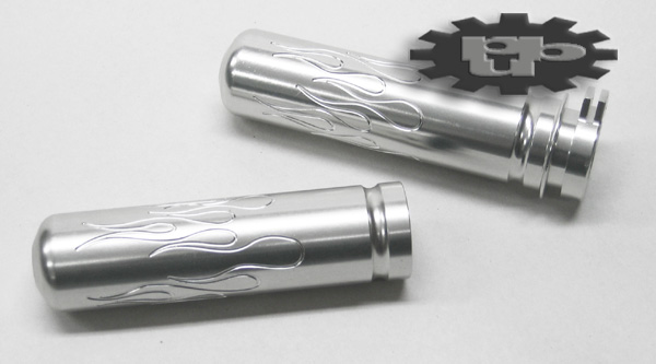

i've been using these: HONDA CFR50 & XR50 - Sik50's Billet Throttle -7/8" Bar. they're on the "bay" for 30 bucks.
you gotta use your original throttle cable guide, but they work great.
nice twisties, but take a gander a these puppies :D
i have a set of the plain aluminum ones OTW for spring ;)
