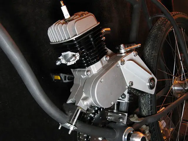

After much deliberation, consideration, pondering, and wandering off to jus' not think about it for awhile - I came up with a forward motor mount! I had initially planned on stealin' Tom's welded design but grew concerned as the shiftkit relies on slight adjustment of the motor's position to tension the secondary drive chain... and the freakin' last thing in the world I wanted was to have any sort of tensioner wheel anywhere on this build lol While I've not had any problems with the ones on my Schwinn and I know sometimes they're needful... I still hates them o.o
It's obv not been welded together or trimmed down yet (I always cut oversize then trim to fit, isa woodworking thang lol) and I'll be makin' a faceplate to hide the half circle on the engine's original mount - but now that it's together it looks simple as heck... tryin' to figure out HOW to make it that way wasn't so simple lol
Oh right - while previously I had used the tools at work (die grinder, bandsaw, etc.) to make the rear motor mounts, I went and got meself a xmas present - a Dremel 4000, the latest and greatest model they've come up with to complement the cordless Dremel Stylus that I've had for years. With the fiber reinforced cut-off wheel it went through that 1/8" steel like butter - far, far faster & easier than the pneumatic die grinder w/a cut-off wheel, which I totally didn't expect o_O
It seems a lil pricey at first glance - but seriously worth every penny if ya wanna machine stuff like this at home: Dremel 4000-3/34 Variable Speed Rotary Tool
